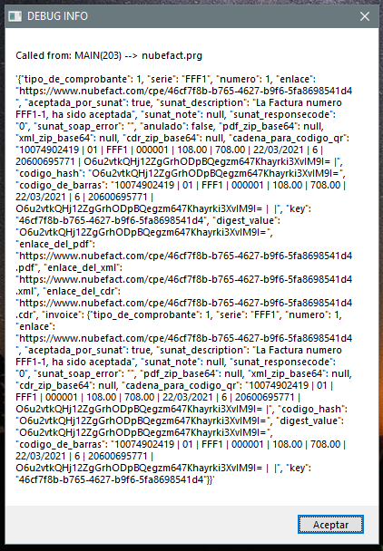

Edk it works !! - Thanks a lot mi friend if you visit Perú some day, I will be your guide.
Here is the response:
Works perfectly !!
Best regards !!
