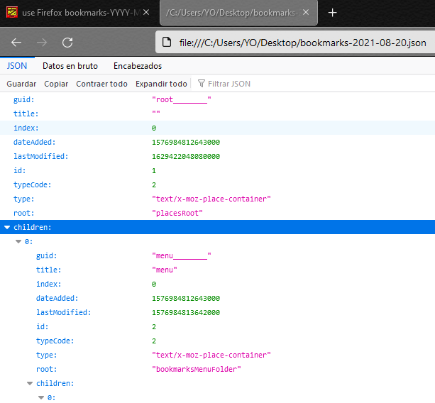

Re: use Firefox bookmarks-YYYY-MM-DD.json
in firefox menu file, OPEN, SEARCH THE json file and look at its structure
2021-08-20 21_27_29-Window.png (29.54 KiB) Viewed 4597 times
