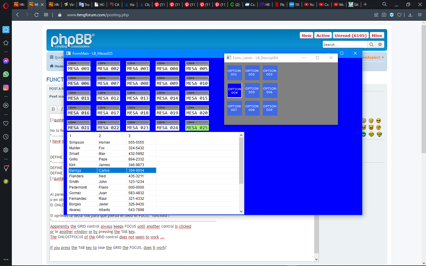

Re: FUNCTION OnMouseHover( hWnd, cFormName )
andyglezl wrote: Sat Sep 04, 2021 5:55 pm
koke wrote: Sat Sep 04, 2021 3:37 pm Hola Andy
Solo agregue un grid en el form no modifique nada de la función.
Google translate
Hello Andy
Just add a grid in the form do not modify anything of the function.
No lo he probado, así a simple vista pudiera ser que no funciona con TEMPLATE...
I have not tested it, so at first glance it could be that it does not work with TEMPLATE ...
DEFINE WINDOW TEMPLATE...
DEFINE WINDOW FormMain ...
DEFINE WINDOW Form_Labels...
Al parecer, el control GRID siempre mantiene el FOCO hasta que se haga click en otro control
o en otra ventana u oprimiendo la tecla TAB.
El ONLOSTFOCUS del control GRID parece que no funciona...
Si yo oprimo la tecla TAB, el GRID pierde el FOCO y funciona, si lo oprimes tú te funciona ?
Apparently the GRID control always keeps FOCUS until another control is clicked
or in another window or by pressing the TAB key.
The ONLOSTFOCUS of the GRID control does not seem to work ...
If I press the TAB key, the GRID loses FOCUS and works, if you press it, will it work for you?

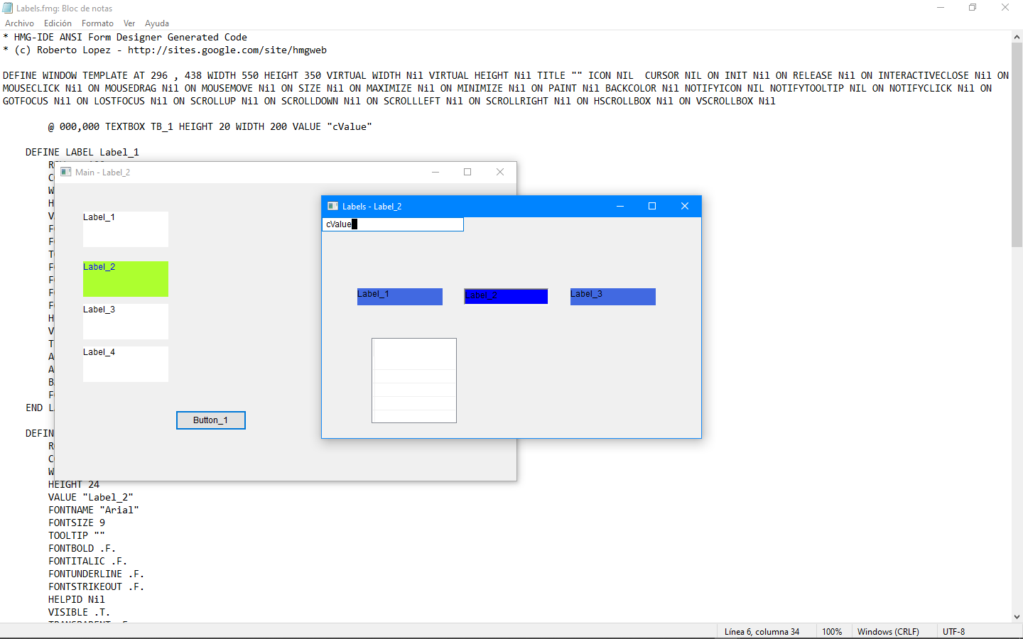

Si defines un control TextBox en la ventana Labels funciona correctamente,
si das click en el GRID, deja de funcionar, Oprimes la tecla TAB o das click
en el TextBox y vuelve a funcionar.
If you define a TextBox control in the Labels window it works correctly,
If you click on the GRID, it stops working, Press the TAB key or click
in the TextBox and it works again.
