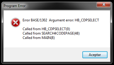

Hi Jimmy... Work fine for me !
but after...
