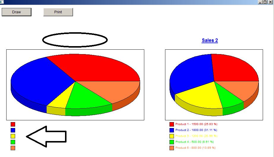

There is a small problem with DRAW GRAPH.
When drawing 2 GRAPHS only the last one gest titles and series,
I took SAMPLES\CONTROLS\GRAPH\GRAPH_04\DEMO.PRG and changed to this code:
function main
	define window m at 0,0 width 1400 height 600 main On Init ShowPie() backcolor { 255,255,255}
		define button x
			row 10
			col 10
			caption "Draw"
			action showpie()
		end button
		Define Button Button_1
			Row	10
			Col	150
			Caption	'Print'
			Action PRINT GRAPH OF m PREVIEW DIALOG
		End Button
	end window
	m.center
	m.activate
return nil
function showpie
ERASE WINDOW m
DRAW GRAPH IN WINDOW m AT 100,15;
      TO 500,500 ;
      TITLE "Sales 1" ;
      TYPE PIE;
      SERIES {1500,1800,200,500,800};
		DEPTH 25;
		SERIENAMES {"Product 1","Product 2","Product 3","Product 4","Product 5"};
		COLORS {{255,0,0},{0,0,255},{255,255,0},{0,255,0},{255,128,64},{128,0,128}};
		3DVIEW;
		SHOWXVALUES;
		SHOWLEGENDS NOBORDER
DRAW GRAPH IN WINDOW m AT 100,550;
      TO 500,900 ;
      TITLE "Sales 2" ;
      TYPE PIE;
      SERIES {1500,1800,1200,500,800};
		DEPTH 25;
		3DVIEW;
		SHOWXVALUES;
return nil
When clicking on the DRAW-Button titles and series are displayed for a second.

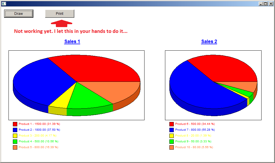

Re: DRAW GRAPH
Hi Serge,
Its seems to be a limitation... :shock:
I prepared this changing that accepts others by naming each graph as control name:
function main
	define window m at 0,0 width 940 height 560 main On Init ShowPie() backcolor { 255,255,255}
		define button x
			row 10
			col 10
			caption "Draw"
			action showpie()
		end button
			Row	10
			Col	150
			Caption	'Print'
			Action MsgInfo("Try to save form to image file with BosTaurus"+CRLF+"and then print it...","Hi Serge") // printgraph1( <"windowname"> , <.lpreview.> , <.ldialog.> )
		End Button
	end window
	m.center
	m.activate
return nil
function showpie
LOCAL aSer1:={1500,1800,200,500,800}
LOCAL aSer2:={500,800,20,50,80}
LOCAL aName1:={"Product 1","Product 2","Product 3","Product 4","Product 5"}
LOCAL aName2:={"Product 6","Product 7","Product 8","Product 9","Product 10"}
LOCAL aColor1:={{255,0,0},{0,0,255},{255,255,0},{0,255,0},{255,128,64},{128,0,128}}
LOCAL aColor2:={{255,0,0},{0,0,255},{255,255,0},{0,255,0},{255,128,64},{128,0,128}}
LOCAL cTitle1:="Sales 1"
LOCAL cTitle2:="Sales 2"
LOCAL nD1:=25
LOCAL nD2:=25
PRIVATE CtrlPiew:=1
ERASE WINDOW m
      TO 500,500 ;
      TITLE "Sales 1" ;
      TYPE PIE;
		DEPTH 25;
		3DVIEW;
		SHOWXVALUES;
      TO 500,900 ;
      TITLE "Sales 2" ;
      TYPE PIE;
		DEPTH 25;
		3DVIEW;
		SHOWXVALUES;
DrawPieGraph1( "m",;
               "CtrlPiew_1",;
		       100,;
		       15,;
		       500,;
		       500,;
		       aSer1,;
		       aName1,;
		       aColor1,;
		       cTitle1,;
		       nD1,;
		       .T.,;
		       .T.,;
		       .T.,;
		       .T. )
               "CtrlPiew_2",;
		       100,;
		       550,;
		       500,;
		       900,;
		       aSer2,;
		       aName2,;
		       aColor2,;
		       cTitle2,;
		       nD2,;
		       .T.,;
		       .T.,;
		       .T.,;
		       .T. )
return nil

      drawarc(windowname,fromrow + depth,fromcol,torow + depth,tocol,middleleftrow+depth,middleleftcol,middlerightrow+depth,middlerightcol)
next i
if lsleg
   fromrow := torow + 20 + iif(l3d,depth,0)
   for i := 1 to HMG_LEN(aname)
      if _iscontroldefined(CtrlPiew+"_pielegend_"+ALLTRIM(STR(i,3,0)),windowname)
         _releasecontrol(CtrlPiew+"_pielegend_"+ALLTRIM(STR(i,3,0)),windowname)
      cname := CtrlPiew+"_pielegend_"+ALLTRIM(STR(i,3,0))
      drawrect(windowname,fromrow,fromcol,fromrow + 15,fromcol + 15,{0,0,0},1,colors[i])
      define label &cname
         parent &windowname
         row fromrow
         col fromcol + 20
         fontname "Arial"
         fontsize 8
         autosize .t.
         value aname[i]+iif(lxval," - "+ALLTRIM(STR(series[i],19,2))+" ("+ALLTRIM(STR(degrees[i] / 360 * 100,6,2))+" %)","")
         fontcolor colors[i]
	transparent .t.
      end label
      fromrow := fromrow + 20
   next i
return nil
But there are other details, like as aLocation where _HMG_SYSDATA [ 108 ] is must include or most rightly to sum both piegraphs.
So, as my lack of time I left to prepare other printgraph. But you can try to save it with BosTaurus to a image file...
Re: DRAW GRAPH
Thx Pablo for your time and willingness!
I can wait, Serge
