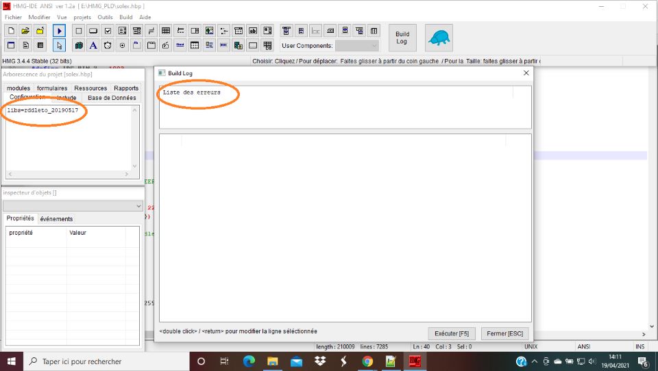

Post by fouednoomen »
i already use libs=rddleto_20190517 in my project
please see the image error on the left
Re: implement LETODB
you wrote:
libs=librddleto_20190517
you should use:
fouednoomen
Posts: 188
Location: Tunisia
from your link the are only librddleto_20190517.a file , i will rename to rddleto_20190517.a and i try
hope every thing going well .
many tanks
fouednoomen
Posts: 188
Location: Tunisia
same error ,
You don't have to rename file!
All lib filenames compiled with MinGW start with prefix LIB
But, in configurations tab, you don't use this prefix, simply writing:
