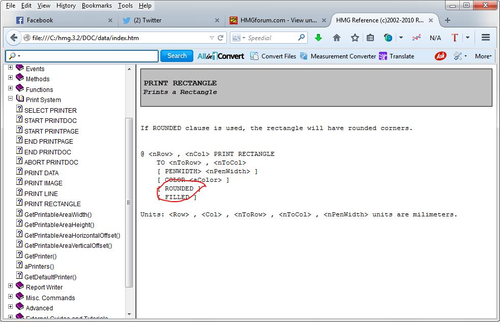

Dear All,
Maybe this info will be useful, on HMG DOC :
I tried this :
@10, 10 PRINT RECTANGLE ;
  TO 20, 20 PENWIDTH 0.1 ;
  ROUNDED FILLED
I got an compile error !
To make it work, change "ROUNDED FILLED" to "FILLED ROUNDED"
  FILLED ROUNDED
Maybe its good to put the FILLED before ROUNDED in HMG Doc.

HMG Manual on PRINT RECTANGLE Miss Leading ?
hmgchang wrote:To make it work, change "ROUNDED FILLED" to "FILLED ROUNDED"
Thank you Mr. Chang for your reporting.
