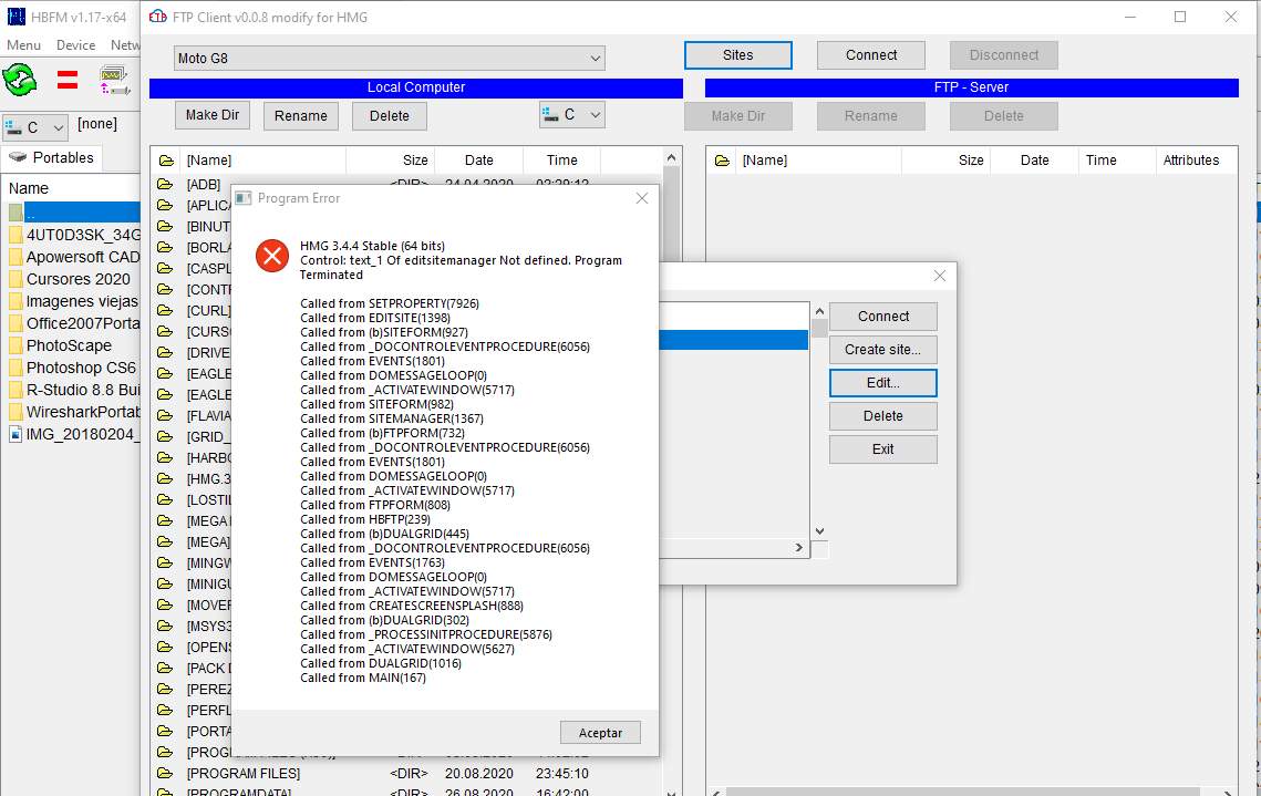

Hi jimmy :
crash in edit ftp server
I create a site
Site name: Moto g8
FTP Server: 192.168.1.39:8556
"Save"
Button Connect
"Connectionis not opened" button accept
Button Sites, button edit
2020-08-27 12_15_17-HBFM v1.17-x64.png (75.58 KiB) Viewed 10074 times
Re: NC Clone

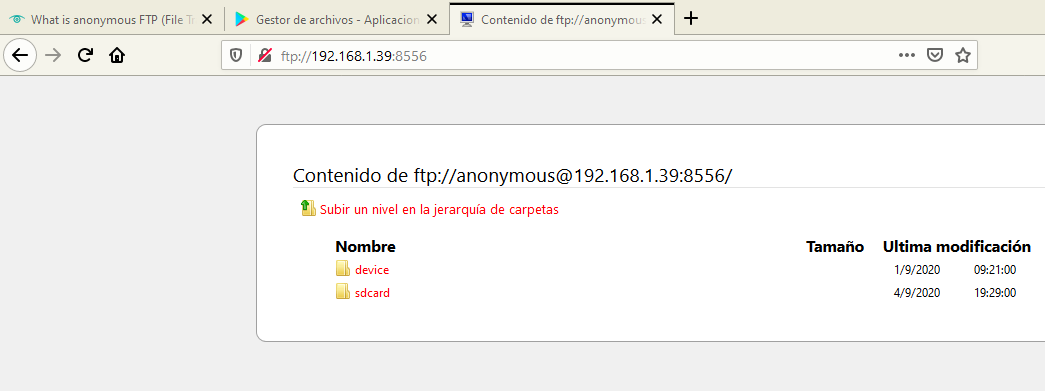

Hi Jimmy
n android file manager I generate an ftp server, from my HP4530s I3 notebook with windows 10 I connect through File Explorer or Firefox just by typing FTP://192.168.1.2:8556 and I can copy, move or any FTP command within my Motorola G8 plus.
with HBFM64 the application hangs entering 192.168.1.2:8556 without username and password or with username: anonimous, password: anoimous
I must use the windows Task Kill to kill the HBFM64 process
2020-09-09 02_00_39-Window.png (12.58 KiB) Viewed 9853 times
https://play.google.com/store/apps/deta ... ager&hl=es
Re: NC Clone
ftp://anonymous:anonymous@192.168.1.39:8556
or ftp://192.168.1.39:8556
File Explorer Windows 10.png (9.25 KiB) Viewed 9847 times
There must be an error in the URL string since you only ask for an address and not an address and port which is what the assembly asks for TUrl()
