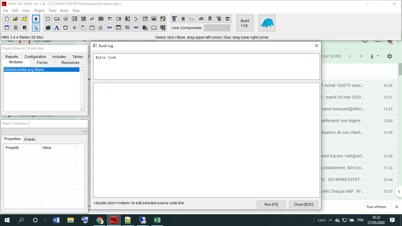

we need CStruct.ch
fouednoomen
Posts: 188
Location: Tunisia
Re: libxlsxwriter -> XlsxReader ?
Post by fouednoomen »
Posts: 3309
Hi Jimmy,
How to compile and how to use it?
Thx, Serge
Posts: 3309
This lines gives error:
4893  #include "C:\Users\Apollo1\Downloads\hblibxlsxwriter-master\xlsxwriter.h"
