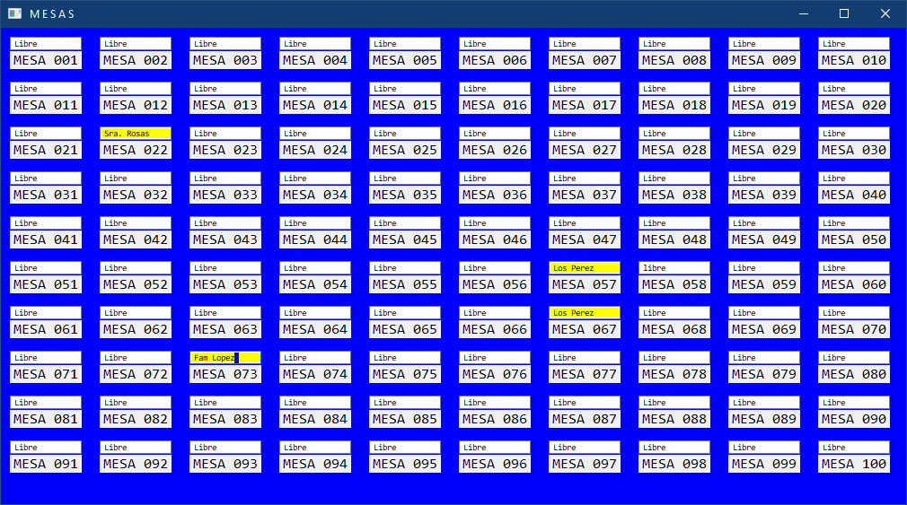

Re: Mover controles con el mouse en tiempo de ejecucion
Hola
No es lo mismo, pero igual la idea puede servir...
It is not the same, but the idea may still serve ...
FUNCTION Main()
 	LOCAL nReng := 10  ;  nColu := 10  ;  nVeces := 1
	DEFINE WINDOW FormMain AT 0 , 0 WIDTH 1024 HEIGHT 570 MAIN BACKCOLOR BLUE TITLE " M E S A S "
	FOR i1 = 1 TO 10
		FOR i2 = 1 TO 10
			cCtrlPso := "LB_Descrip"+STRZERO( nVeces, 3 )
			// Capturar la Descripcion que se desee...
			@ nReng,nColu TEXTBOX &cCtrlPso. OF FormMain VALUE "Libre" WIDTH 80 HEIGHT 15 FONT "Consolas" SIZE 8 ON ENTER ( ActMesa( This.Name, This.Value ) )
			cCtrlPso := "LB_Mesas"+STRZERO( nVeces, 3 )
			@ nReng+16,nColu LABEL &cCtrlPso. OF FormMain VALUE "MESA "+STRZERO( nVeces, 3 ) WIDTH 80 HEIGHT 20 FONT "Consolas" SIZE 12 CENTERALIGN
			nColu += 100
			nVeces += 1
		nColu := 10
		nReng += 50
    CENTER WINDOW FormMain
    ACTIVATE WINDOW FormMain
FUNCTION ActMesa( cNombre, cDesc )
	SetProperty( "FormMain", "LB_Descrip"+RIGHT( cNombre, 3 ), "BACKCOLOR", IF( UPPER( ALLTRIM( cDesc ) ) <> "LIBRE", YELLOW, WHITE ) )

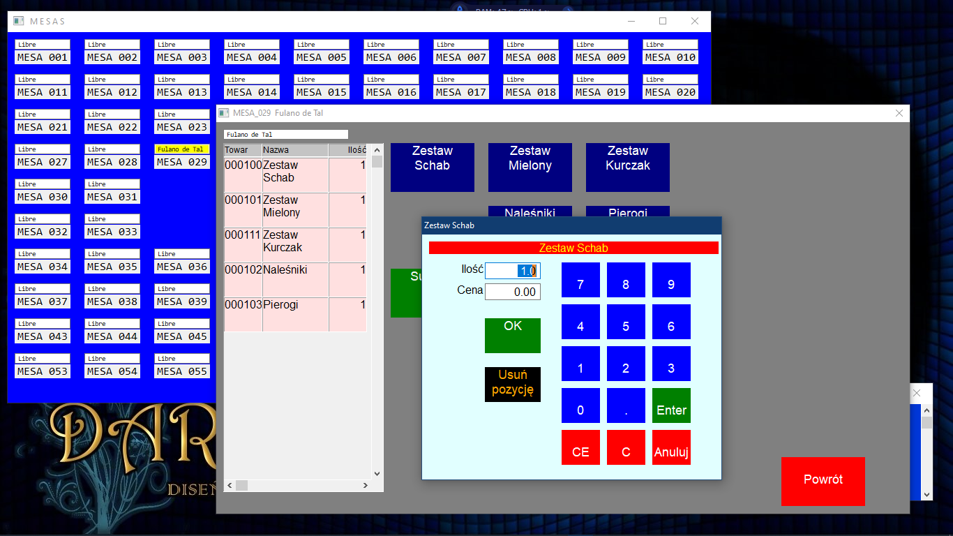

Con el POS de Marek...
With Marek's POS ...
#include "hbclass.ch"
FUNCTION Main()
 	LOCAL nReng := 10, nColu := 10, nVeces := 1, aMapa := ARRAY( 10 )
	aMapa[ 1]  := "1111111111"
	aMapa[ 2]  := "1111111111"
	aMapa[ 3]  := "1111000011"
	aMapa[ 4]  := "1110000000"
	aMapa[ 5]  := "1100000000"
	aMapa[ 6]  := "1100000000"
	aMapa[ 7]  := "1110000000"
	aMapa[ 8]  := "1111000011"
	aMapa[ 9]  := "1111111111"
	aMapa[10]  := "1111111111"
	// ************Touch system  MOL-Systemy Komputerowe mol@pro.onet.pl
	public nLiczbaWierszy	:= 5
	public nLiczbaKolumn	:= 5
	public aStosPlansz := {}
*	private cNazwaOkna := "Form_Main"
	private aPozycje := {}
	private aHeaders := {'Towar','Nazwa','Ilość'}
	private aWidths := {55,95,55}
	private aJust	:= {0,0,1}
	private oMiniGrid
	aPlansza1 := {	{ 1,1,"Zestaw"+chr(10)+"Schab","T","000100"} ,;
					{ 1,2,"Zestaw"+chr(10)+"Mielony","T","000101"} ,;
					{ 1,3,"Zestaw"+chr(10)+"Kurczak","T","000111"} ,;
					{ 2,2,"Naleśniki","T","000102"} ,;
					{ 2,3,"Pierogi","T","000103"} ,;
					{ 3,1,"Surówki","P",2} ,;
					{ 3,2,"Napoje","P",3} }
	aPlansza2	:=	{	{ 1,1, "Kapusta"+chr(10)+"biała", "T", "000201"} ,;
					{ 1,2, "Kapusta"+chr(10)+"czerwona", "T", "000202"} ,;
					{ 1,3, "Kapusta"+chr(10)+"MIX", "T", "000203"} ,;
					{ 2,1, "Buraczki", "T", "000204"} ,;
					{ 2,2, "Marchewka", "T", "000205"} ,;
					{ 2,4, "Seler", "T", "000206"} }
	aPlansza3	:=	{	{ 1,1, "Cola 0,5l", "T", "000301"} ,;
					{ 1,2, "Pepsi 0,2l", "T", "000302"} ,;
					{ 1,3, "Jurajska 0,5l", "T", "000303"} ,;
					{ 2,1, "Tymbark"+chr(10)+"jabłko"+chr(10)+"mięta", "T", "000304"} ,;
					{ 2,3, "Kawa express", "T", "000305"} ,;
					{ 3,3, "Herbata", "T", "000306"} }
		FOR i1 = 1 TO 10
			FOR i2 = 1 TO 10
				IF SUBSTR( aMapa[ i1 ], i2, 1 ) = "1"
					@ nReng,nColu TEXTBOX &cCtrlPso. OF FormMain VALUE "Libre" WIDTH 80 HEIGHT 15 FONT "Consolas" SIZE 8  ;
								  ON ENTER ( ActMesa( This.Name, This.Value ) ) // TOOLTIP ( This.Value )
					@ nReng+16,nColu LABEL &cCtrlPso. OF FormMain VALUE "MESA "+STRZERO( nVeces, 3 ) WIDTH 80 HEIGHT 20 FONT "Consolas" SIZE 12 CENTERALIGN  ;
									 ACTION WinPtoVta( This.Value ) TOOLTIP ( "Point of Sale" )
					nVeces += 1
				nColu += 100
			nColu := 10
			nReng += 50
	SetProperty( "FormMain", cNombre, "BACKCOLOR", IF( "LIBRE" <> UPPER( ALLTRIM( cDesc ) ), YELLOW, WHITE ) )
FUNCTION WinPtoVta( cValue )	// Define Window
	LOCAL ChildForm := STRTRAN( cValue, " ", "_" )
	LOCAL xCtrol := "LB_Descrip"+RIGHT( cValue, 3 )
	LOCAL aCtrol := GetProperty( "FormMain", xCtrol, "Value" )
	IF ! IsWindowDefined( &ChildForm )
		DEFINE WINDOW &ChildForm AT 0 , 0 WIDTH 1000 HEIGHT 590 WINDOWTYPE CHILD NOSIZE NOMINIMIZE NOMAXIMIZE BACKCOLOR GRAY	// { 112 , 128 , 144 }
			ON KEY ESCAPE ACTION ( ThisWindow.Release )
			SetProperty( ChildForm, "Title", ChildForm + "  " + aCtrol )
			@ 010 , 010 TEXTBOX TBX01 OF &ChildForm VALUE aCtrol WIDTH 180 HEIGHT 15 FONT "Consolas" SIZE 8  ;
						ON CHANGE ( SetProperty( ChildForm, "Title", ChildForm + "  " + This.Value ), ;
									SetProperty( "FormMain", xCtrol, "Value", This.Value ), ;
									ActMesa( xCtrol, This.Value ) )
			// Aquí, tu proceso de Punto de Venta...
			// Here, your Point of Sale process ...
			TouchSystemMol( ChildForm )
		CENTER WINDOW &ChildForm
		ACTIVATE WINDOW &ChildForm
		DoMethod( ChildForm, "SetFocus")

		define grid G_Pozycje
			row 10
			col 10
			WIDTH 230
			HEIGHT 100
			HEADERS {'Towar','Nazwa','Ilość'}
			WIDTHS {60,100, 60}
			fontname "ARIAL"
			fontsize 8
			ITEMS NIL
			OnQueryData OdswiezPozycje()
			ONDBLCLICK  PoprawPozycje(this.Value)
			VIRTUAL .t.
		end grid
		oMiniGrid := MiniGrid():New( SUBSTR( cFormName, 6, 3 ), 30, 10, 230, 500, 250, 5000, aHeaders, aWidths, aJust)
		for w := 1 to nLiczbaWierszy
			for  k:= 1 to nLiczbaKolumn
				cNazwaPrzycisku := "Przycisk_"+str(w,1)+str(k,1)
				bBlock := "WykonajAkcjePrzycisku(" + str(w,1) + "," +str(k,1) + ")"
				@ nWiersz + (w-1)*(nWysokosc+nPrzerwa), nKolumna + (k-1)*(nSzerokosc +nPrzerwa) LABEL &cNazwaPrzycisku ;
					width nSzerokosc height nWysokosc ;
					VALUE cNazwaPrzycisku;
					font cNazwaCzcionki size nRozmiarCzcionki centeralign FONTCOLOR WHITE;
					action &bBlock ;
					backcolor BLUE
			next k
		next w

		@ nWiersz + nLiczbaWierszy*(nWysokosc+nPrzerwa), nKolumna+ (nLiczbaKolumn-1)*(nSzerokosc +nPrzerwa) LABEL L_Powrot ;
			VALUE chr(10)+"Powrót";
			action ZamknijPlanszeSprzedazy() ;
			backcolor RED
*	END WINDOW

	DEFINE WINDOW OknoPoprawPozycje ;
		WIDTH nKolumna + 40 + nLiczbaKolumn*(nSzerokosc+nPrzerwa) HEIGHT nWiersz + 40 + nLiczbaWierszy*(nWysokosc+nPrzerwa) ;
        TITLE STRTRAN(aPozycje[nPozycja,2],CHR(10)," " ) ;
		MODAL ;
		backcolor aKolorTla;
		NOSIZE NOSYSMENU
	@ 10,10 LABEL L_Towar ;
		width 300 height 18;
		VALUE STRTRAN(aPozycje[nPozycja,2],CHR(10)," " ) ;
		font "ARIAL" size 12 CENTERALIGN FONTCOLOR YELLOW backcolor RED
	@ 40, 10 LABEL L_Ilosc ;
		width 78 height 18 ;
		Value "Ilość" ;
		font "ARIAL" size 12 rightalign
	@ 40, 90 TEXTBOX T_ILOSC ;
		width 80 height 24 ;
		Value aPozycje[nPozycja,3] ;
		font "ARIAL" size 12;
		NUMERIC INPUTMASK "99.9" ;
		ON GOTFOCUS {|| cBiezacaKontrolka := this.name, CBiezacyTekst := "cIloscTekst"} ;
		rightalign
	@ 70, 10 LABEL L_Cena ;
		Value "Cena" ;
	@ 70, 90 TEXTBOX T_CENA ;
		Value aPozycje[nPozycja,4] ;
		NUMERIC INPUTMASK "9999.99" ;
		ON GOTFOCUS {||cBiezacaKontrolka := this.name, CBiezacyTekst := "cCenaTekst"} ;
		rightalign
	@ 120, 90 LABEL L_OK ;
		width 80 height 50 ;
		Value "OK" ;
		backcolor GREEN;
		font "ARIAL" size 14 FONTCOLOR WHITE;
		CENTERALIGN ;
		ACTION ZapiszPoprawePozycji()
	@ 190, 90 LABEL L_UsunPozycje ;
		Value "Usuń pozycję" ;
		backcolor BLACK;
		font "ARIAL" size 14 FONTCOLOR ORANGE;
		CENTERALIGN ;
		ACTION UsunPozycje()
		aNazwyPrzyciskow	:= {{"7","8","9"}	,{"4","5","6"},{"1","2","3"},{"0",".","Enter"},{"CE","C","Anuluj"}}
		aWartosciPrzyciskow := {{"7","8","9"}	,{"4","5","6"},{"1","2","3"},{"0",".","ENTER"},{"CE","C","ANULUJ"}}
		aKoloryPrzyciskow	:= {	{BLUE,BLUE,BLUE},;
									{BLUE,BLUE,BLUE},;
									{BLUE,BLUE,BLUE},;
									{BLUE,BLUE,GREEN},;
									{RED,RED,RED}}
		for w := 1 to len(aNazwyPrzyciskow)
			for  k:= 1 to len(aNazwyPrzyciskow[1])
				if !empty(aNazwyPrzyciskow[w,k])
					bBlock := "WykonajAkcjePrzyciskuKlawiaturowego(" + str(w,1) + "," +str(k,1) + ")"
						VALUE chr(10) + aNazwyPrzyciskow[w,k];
						action &bBlock ;
						backcolor aKoloryPrzyciskow[w,k]
			next k
		next w
	OknoPoprawPozycje.L_Towar.Width := OknoPoprawPozycje.Width - 20
	CENTER WINDOW OknoPoprawPozycje
	ON KEY ESCAPE OF OknoPoprawPozycje ACTION OknoPoprawPozycje.Release
	ACTIVATE WINDOW OknoPoprawPozycje
 RETURN nRet

	&cBiezacyTekst := cWartosc
 return
function ZapiszPoprawePozycji
	aPozycje[nPozycja, 3] := OknoPoprawPozycje.T_Ilosc.Value
	aPozycje[nPozycja, 4] := OknoPoprawPozycje.T_Cena.Value
	nRet := .t.
 return
function UsunPozycje
	if MsgYesNo("Potwierdź usunięcie pozycji")
		aDel(aPozycje, nPozycja)
		aSize(aPozycje, len(aPozycje)-1)
		oMiniGrid:DeleteRow(nPozycja)
		//SetProperty(cNazwaOkna, "G_Pozycje","ItemCount",len(aPozycje))
return
function PoprawPozycjeMiniGrid
	param nPozycja
	local k
	local cLabelName
	if PoprawPozycje(nPozycja)
		oMiniGrid:ChangeRow(nPozycja)
 return
