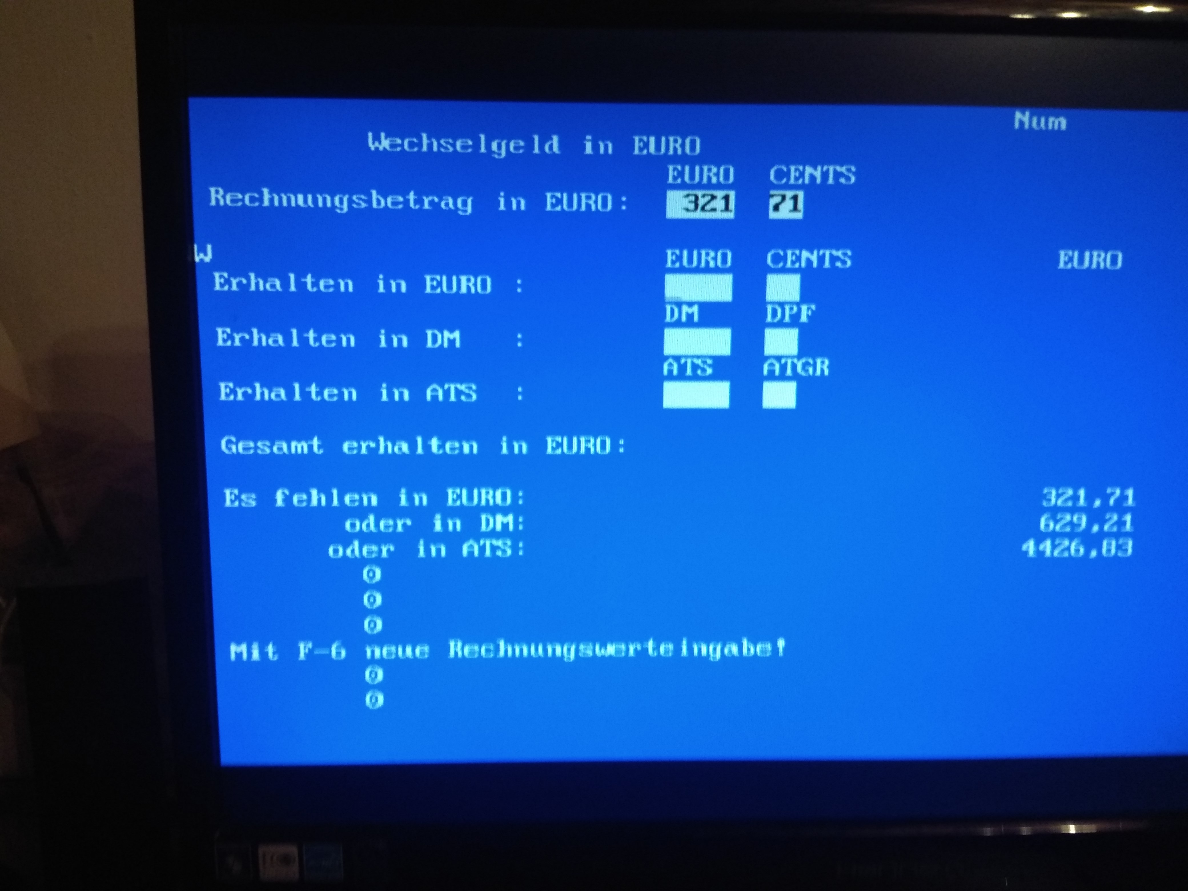

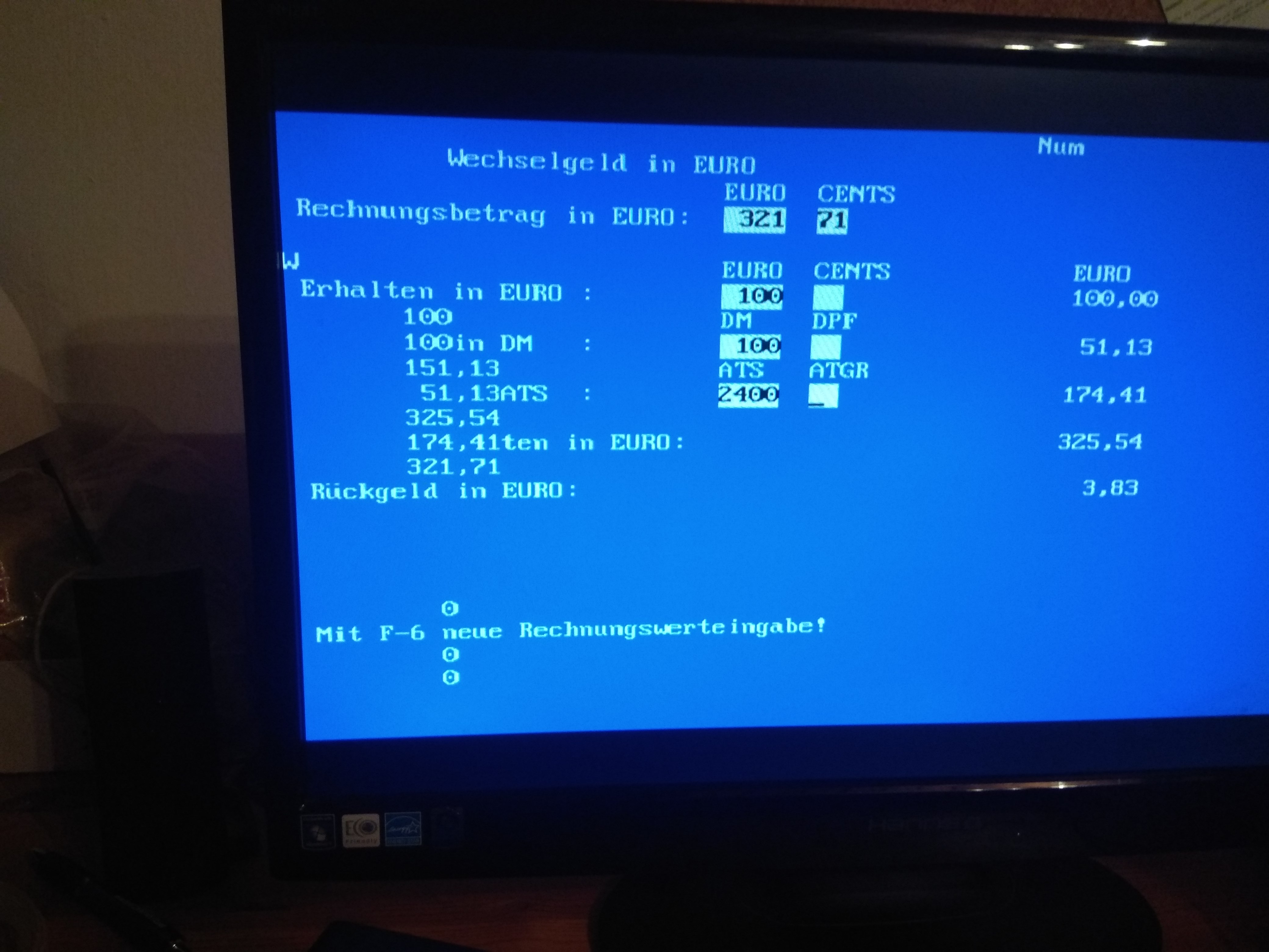

OT: for nostalgic reasons, please allow me to show you photos of a quick and dirty dos-program (I found no way to make screenshots of Dosbox for Linux). In 2002 the € was introduced. In the company I was employed until I retired in October 2018, customers came to buy and payed cash. So we had 3 currencies: Old German "DM und Pfennig", Old Austrian "Schilling and Groschen" and New "€ und Cents".
The invoice was in new €. But the old currencies still were valid and we were obliged to accept them. My program, written in Dbase 5.1 for Dos had those features:
You typed in the € value.
The program told you how much you had to pay in € ,DM or AT. Every time you typed in how much you got cash in either DM, ATS or € the missing value (if any) changed in €, DM or ATS. You could even overpay, the change was calculated in €.
I was very proud of my prog and the workmates were very happy with that tool.
3 weeks later, the program was no longer needed, the € had taken over. But my workmates never forgot this helpful program.
Long live HMG
Robert
