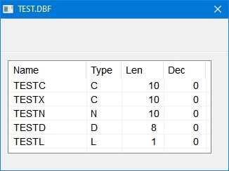

calculate GRID height
Posts: 2093
i try to calculate Size of GRID ... but something is wrong with my calculation
i use Arial 11 and this line
   nHeight := ( iMax + 1 ) * 22.3
+1 is need for GRID Header and 22.3 ...
it seem to work when have < 10 Fields but than GRID is bigger than need :(
so i need a better Way for "calculation" height of GRID.
please help, thx

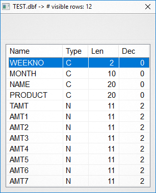

Hi Jimmy,
I had revised the above code and added the two new clauses:
AUTOSIZEHEIGHT <nRow> and AUTOSIZEWIDTH <.T.|.F.>
to a standard Grid control in MiniguiEx. 8-)
The updated program code and a result's screen are below: :arrow:

Posts: 2093
Re: calculate GRID height
gfilatov wrote: Fri Feb 14, 2020 9:15 am I had revised the above code and added the two new clauses:
that looks fine, THX
