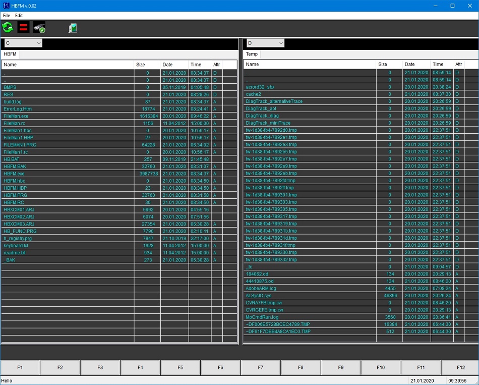

this is the Sample i found when search for "GetVolumeInformation" in c:\MiniGUI\SAMPLES\Advanced\FileMan\
it is easy to use existing Code and modify it but i want to learn how it work.
1.) use a VIRTUAL GRID and change Array "on-fly" when change Directory (working)
2.) resize on PC an Table PC ( Landscape / Portrait )
3.) integrate own OSK
4.) Dark-Mode
- HBFM_002.jpg (295.8 KiB) Viewed 9592 times
i notice that MiniGUI Sample does not maximize, so the Work was (again) to write Code for ON SIZE / ON MAXIMIZE
i have try to use SPLITBOX but it is not what i use as CLASS under Xbase++ ... it is a ReBar
those things i have to learn and that why i try to "re-engine" my Xbase++ Code under harbour / HMG
Source for c:\MiniGUI\SAMPLES\Advanced\FileMan\ is a BIG help.
i have try to use TAB to switch left/right but i put my Code on wrong place (ONKEY of GRID)
i have to put it into MAIN Windows to override "other" (e.g. TabPage which TABSTOP .T.)
