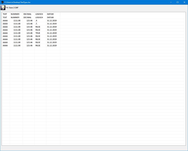

i have prepare 1st Demo to show how to get a Excel Sheet using COM into Array and show it in GRID
it also include This.CellColIndex BUG which show Col+1 :shock:
Array get from Excel are Column so we need to convert it to Row :!:

now we got Data in GRID but it might be that not all belong to "Data" which we want to transfer.
Programmer "expect" that in 1st ROW are Header ... but what it 1st ROW contain "other" data ?
also End must not be last Row so we need nStart, nEndRow ... and nEndCol (click in Header to show BUG)
if we got the Area we still can have Problem with FIELDPUT() while VALTYPE() might incorrect e.g. NIL
not sure about International Version of Excel : does it use "," or "." for Decimal :?:
i have to figure out how to get "Nation" Sign e.g. for "empty" Date like " . . " or " / / "

look at Sample 1st Data Row.
1st Column "seem" Type "N" but if you scroll down you will see A-Z so this Column ist Type "C"
Column 3 & 4 have NIL and it seems Type "N" but how long (LEN) and how many Decimal :?:
if i use VAR2CHAR(Number) to get a String and count LEN() i got 6 but when scroll down you will see bigger Number so it is 7.

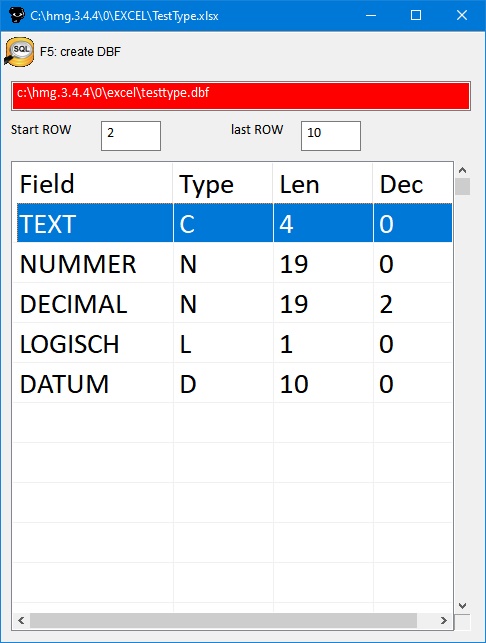

next Windows show Structure
here you still can change Structure before start transfer but i do NOT check e.g. FIELD Name (A-Z, 0-9 and NO Number on Front)
i recommend to use F9 and use other line in "Data-Area" for Structure.

now you got the Source to get a Excel Sheet into DBF / SQL but it only work with "optimal" Sheet.
i have got o:Numberformat for every Column from Excel but i only use it to show it on Header.
Part 3 is try to "automate" F5-F9 to find Start/Data/End and right Structure.
when have a bad Structure you will get a Error Message which point to Line in Row.
you have use that Row Number for "next try" to find a Row which match all.
when have o:Numberformat in some case it will "confirm" what get with VALTYPE()
... but it also can "confuse" you so the Question is what is right :roll:
so i don't want to release Part 3 "as Code" while there a too many Ways so we have to discuss if a Way will produce right Value or fail
