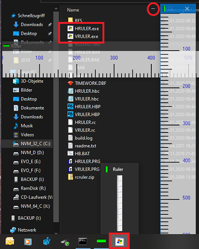

have made simple "pure" HMG_Ruler
include Source and Icon as Resource.
please have a look at this Snapshot. Explorer does not show EXE Icon :?:
and why in Tasklist vertical Icon is not shown :?:
HMG_RULER.ZIP
(3.43 KiB) Downloaded 191 times
as the vertical is only 120 wide i can't use Titlebar to move it ... and it have a Artifact left of it.
how can i get ride of of Min/Max Button Space (!) under HMG :?:

Re: App as Ruler
new Version :
5 Point mark
Context Menu for Transparency
NOMAXIMIZE NOMINIMIZE -> no Artefact
now vertical Ruler can be moved using Titlebar
here is the Source
