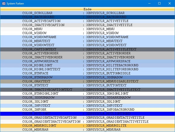

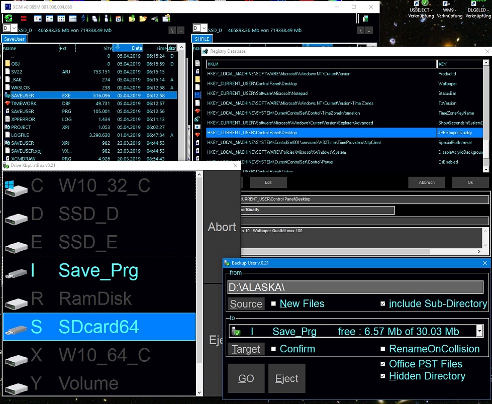

just found this Thread and all those Skin
i have used Codejock SkinFrameWork until DarkMode of Windows 10.
it work 99% stable ... but i don't use it in "Production" only "Presentation"
those tool does "hack" deep into OS to redirect Theme Color of visual Style ...
under Windows 10 Theme look more like Classic Style and in Darkmode you just have BLACK as Background.
i have a DBF with my own Color. i have "Read" (GetSysColor()) those 30 Color from Skin Theme Color e.g. Office 2009 or iTunes so User can choose what Theme Color he/she want.
i like Windows 10 Darkmode and this are my Color all my Xbase++ App use same THEME.DBF so they look same
have not test it yet with harbour / HMG but with Xbase++ i have to use Ownerdraw to "overrule" Windows (Theme) Color.
i have only 1 Problem : get "automatic" Scrollbar to paint it black ...
