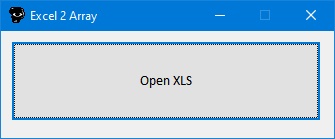

Re: ExcelToDBF
here is a Demo using COM to access XLS into Array and display it in a GRID
! Note : need Excel installed ;)
hb_DBFEXCEL.zip
(1.26 MiB) Downloaded 397 times
it is only Array yet and next Step is to transfer into DBF / SQL
but GRID show that Array is correct while Array direct from Excel are "Column" instead of "Row" under harbour / HMG :!:
i will make a new Thread when finish DBF Field Name, Type, Len Selection to get a proper DBF / SQL Table.

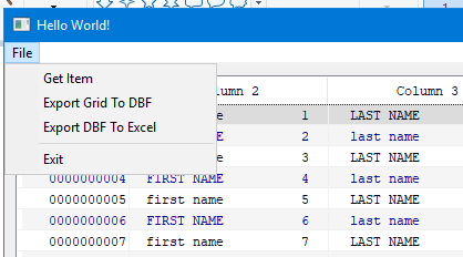

Re: ExcelToDBF
Refer example at C:\MiniGUI\SAMPLES\BASIC\GRID_8
You will find Export Grid to Dbf and
Export Dbf to Excel
The main benefit of ExcelToDBF Add-is not limited to export in Dbf
What I am enjoying is to open Dbf file in Excel do all the work like Excel file i.e. add/delete column/Row, add data using formula etc.
I can not found such Easiness in any other software

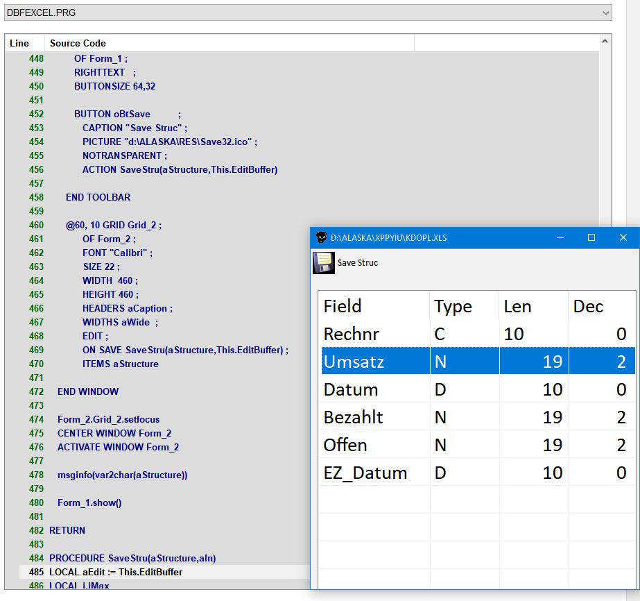

Re: ExcelToDBF
thx for your link to MiniGUI Sample.
but it does work "other" Way from DBF or GRID to Excel :!:
i want to read a Excel Sheet and transfer Data to DBF / SQL
that is what Demo Sample is doing.
next Step is "easy" if a xBase Programmer have create XLS but if a User ... :roll:
we know that FILED Name can only have 10 Sign and " " Space is not allowed
so i'm working on a Structure Modul which get Result from "FindHeaderLine()"
for more Information e.g. LEN i sort Column Type "C" to get "longest" Sting to fit into FIELD
a xBase Programmer "expect" Header for Column in 1st ROW ...
but User can put some line before e.g. Name, Adresse etc.
so just must have the Choise "where" to start with "Data" to transfer from Array
now i got to that point that i have create Modul with GRID but i can't "ON SAVE" it :o
i can EDIT and change it but "ON SAVE" is not fired and ARRAY is not change.
i saw working Sample but they use DBF not ARRAY.
so how to use This.EditBuffer when change something in GRID :?:
