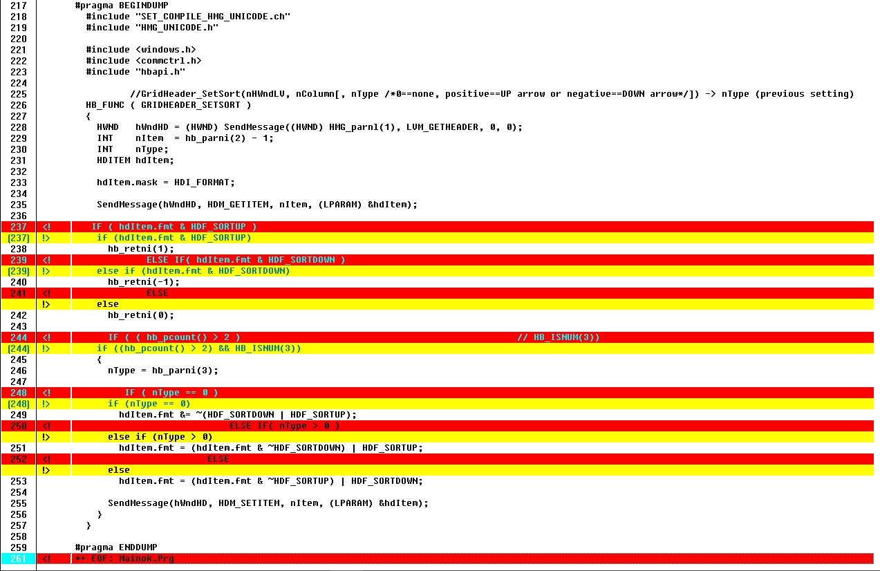

it will FAIL on HB_FUNC Code ... :o
those Code will give Error when compile but i don't know why :?:
here you can see what Windiff.EXE give me.
in produced Code that "C" Part look Different while it is (wrong) Indent. so it look different to WinDiff.EXE ... hm ...
i think it need a HEX Editor to see what is going on ... :roll:
