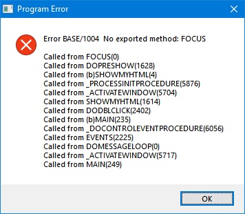

thx for Tip but
C:\hmg.3.4.4\0\MAIL\email.prg(1628) Error E0030 Syntax error "syntax error at '.'"
but is is the same Idea as i had but i fail too

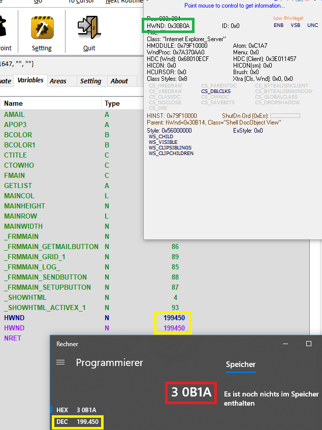

i still try to set Focus into AX Control.
now i saw in Debugger :shock:
i got Hwnd this Way
   hWnd := GetControlHandle( 'Activex_1', "ShowHtml" )
so what can make the Difference :?:
p.s. the App i use is WinID https://www.dennisbabkin.com/winid/
