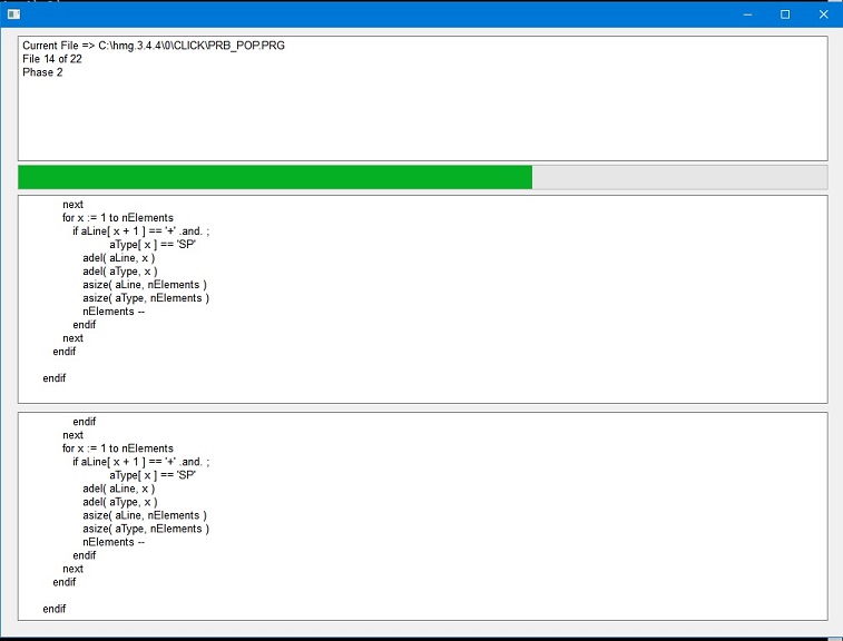

prg code function documentor in HMG
since Console Output is so slow i want to make a GUI Version.
i try EDITBOX (WC_EDIT multi-line ) as Output
   cDummy := GetProperty("ClickForm","InBox","Value")
   cDummy += CRLF
   cDummy += cData
   SetProperty("ClickForm","InBox","Value",cDummy)
but than Memory grow up until it crash
Unrecoverable error 9006: hb_xgrab can't allocate memory
hm ... it was the Way i use under Clipper (Memo) / Xbase++ (XbpMLE) but here it "react" in other Way
YES i do "reset" Memory in procedure TheAligner() when Code is "Output"
so how can i show cData (it is one Line) under GUI ... :idea:
it does not make sence to "fill" a Control when action is just some Seconds
procedure show_in( cData )
procedure show_out(cData ... )
procedure centertext( cSomeText ... )
here is the FMG (only) which i use now
ClickForm.zip
(768 Bytes) Downloaded 366 times
p.s. Time raise from 2 Seconds to 20 Seconds but that would be OK when i "see" Code ...

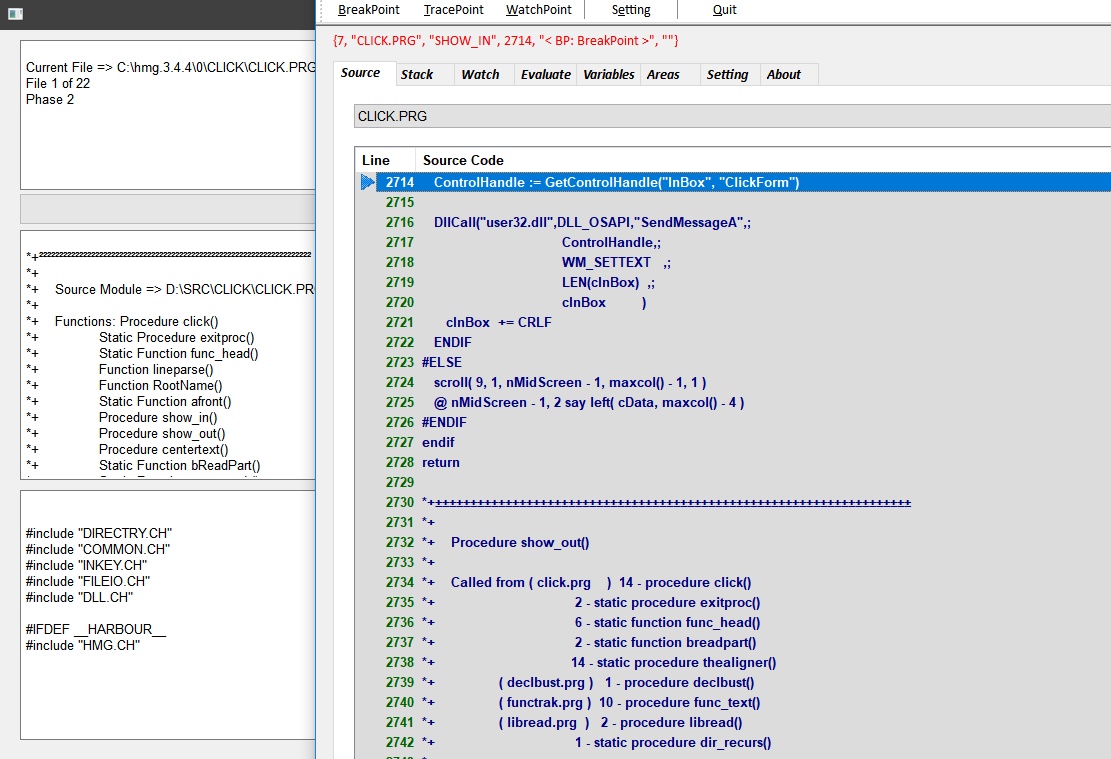

have try to use API with WM_SETTEXT
PROCEDURE SetStatusText(cData)
LOCAL ControlHandle
   cStatusBox += cData
*   SetProperty("ClickForm","StatusBox","Value","")
*   SetProperty("ClickForm","StatusBox","Value",cStatusBox)
*   SetProperty("ClickForm","StatusBox","CaretPos", -1 )
*   ClickForm.StatusBox.Value    := ""
*   ClickForm.StatusBox.Value    := cStatusBox
*   ClickForm.StatusBox.CaretPos := -1
   ControlHandle := GetControlHandle("StatusBox", "ClickForm")
   IF !EMPTY(ControlHandle)
*     DllCall("user32.dll",DLL_OSAPI,"SendMessageA"  ,;
*                                   ControlHandle  ,;
*                                   WM_SETTEXT     ,;
*                                   LEN(cStatusBox),;
*                                   cStatusBox      )
*     DllCall("user32.dll",DLL_OSAPI,"InvalidateRect",ControlHandle  ,1)
      SendMessage(ControlHandle  ,;
                  WM_SETTEXT     ,;
                  LEN(cStatusBox),;
                  cStatusBox      )
      InvalidateRect (ControlHandle, NIL ,.F.)
   cStatusBox += CRLF
but it does not show anything ... hm
funny also a have 3 x Editbox but it does not show Text when run "normal"
using Debugger you can "see" that it work but not without Debugger ... :(
does someone have a Tip how to update a Editbox without lose Memory :idea:
hi
i got API running :D
                                   ControlHandle  ,;
                                   WM_SETTEXT     ,;
                                   LEN(cStatusBox),;
                                   cStatusBox      )
*      SendMessage(ControlHandle  ,;
*                  WM_SETTEXT     ,;
*                  LEN(cStatusBox),;
*                  cStatusBox      )
my 1st DLLcall work while harbour Version fail :?:
my 2nd Dllcall fail while harbour Version work :!:
now Memory does not increase and i can "see" Output :D
BUT ... it begin Quick but with every line it get slower and slower ... :(
when got to next PRG ist start again with "full speed" and than slow down.
i know that 32 Bit Apps will get slower when reach 2 GB Limit but i'm far away from Memory Limit now.
as Console show same it must be a serious Problem with harbour which i don't understand.
it does have 3 x EditBox where i want "Output".
it "seem" me that Graphic is "at Limit" an all goes to Queue.
it is like a "Cache". when it is "full" it slow down.
App is so "busy" that you NOT allowed to switch to other App while than it will not show Output any more.
it seems to "stop" when "lost Focus". you just can wait until End or break it.
does some "Sleep" or "DoEvent" help in this Case :idea:
it is is NOT the Code while when using
VERBOSE=NO
in Click.INI it take less than 5 Seconds to do the Work.
what about Thread for each EditBox. how do i "sync" Thread under harbour / HMG :?:
Thread "Input" read Data and "wait" until Thread "Output" is ready to "receive" data.
is the a Sample which show me how it work :?:
as usual here is full Source of Project.
hb_CLICK_2055.ZIP
(60.71 KiB) Downloaded 394 times
please help me to find "Speed" for "Output"

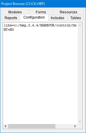

Jimmy,
hbxpp.hbc MUST be in HBP file!
serge_girard wrote: Mon Dec 09, 2019 1:24 pm hbxpp.hbc MUST be in HBP file!
sorry i don't understand.
i write LIBS into "Configuration" of IDE, is this wrong :?:
never-less HMG have a own "DllCall" so i will try to find out how it work so we can get rid of HbXpp.

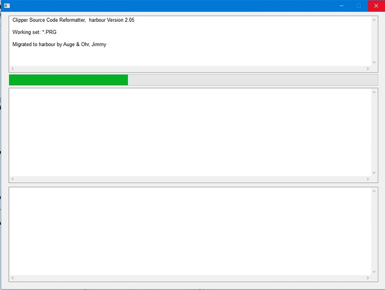

Hi.
I changed the control type from EDITBOX to RICHEDITBOX and used the Addtext property.
Every 250 lines displayed, release memory and do event queue.
click_prg.7z
(18.82 KiB) Downloaded 422 times
Check it now.

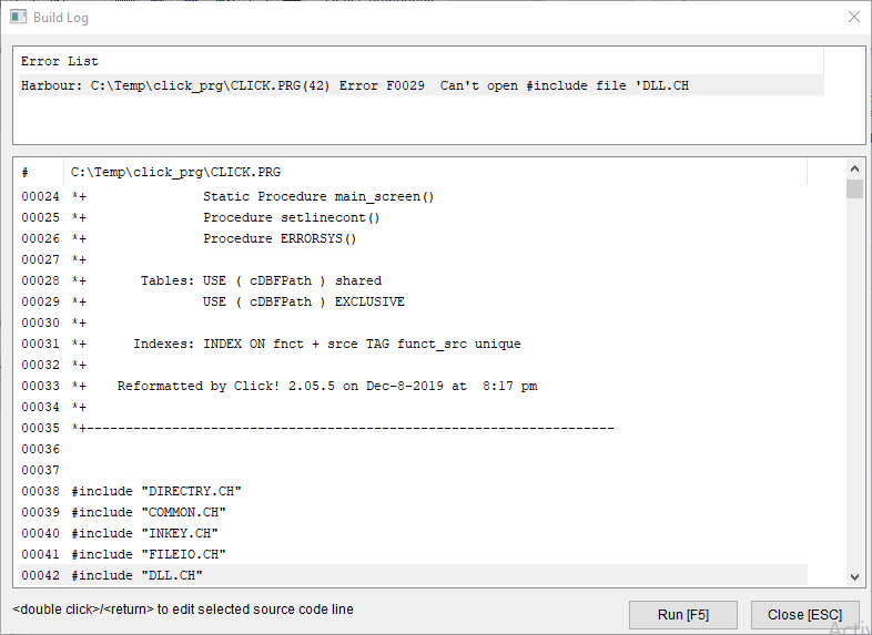

danielmaximiliano wrote: Tue Dec 10, 2019 4:11 pm Falta
sorry that i have use Xbase++ Style and DLL.CH which is not Part of HMG
#ifndef _DLL_CH
#define _DLL_CH
#define DLL_CDECL                   0x08
#define DLL_STDCALL                 0x20
#define DLL_SYSTEM                  0x04
#if defined( __PLATFORM__WINDOWS )
#define DLL_OSAPI                   DLL_STDCALL
#elif defined( __PLATFORM__OS2 )
#define DLL_OSAPI                   DLL_SYSTEM
#else
#define DLL_OSAPI                   DLL_CDECL
#endif
/* Only for compatiblity.
   Harbour always copies the string to a temporary buffer. */
#define DLL_CALLMODE_COPY           0
#define DLL_CALLMODE_NORMAL         DLL_CALLMODE_COPY
#endif /* _DLL_CH */
