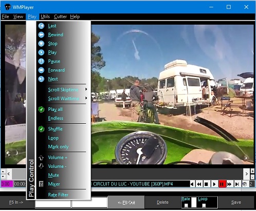

AUGE_OHR wrote: Wed Oct 30, 2019 12:04 pm ... looking for Ownerdraw Menu
It is possible in the Minigui Extended Edition (look at an image below). :arrow:
Dark theme sample
Dark theme sample
