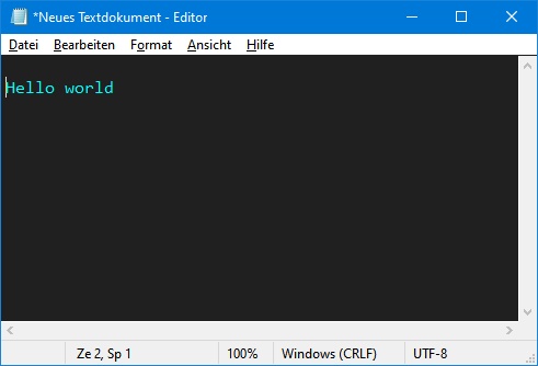

open Notepad and type some Text and leave it open
start with
c:\hmg.3.4.4\build.bat demo1
now you can see how Color of Notepad is change
! Note : Color are for ALL Apps. it will stay until re-Login
