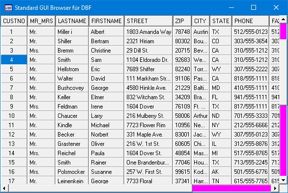

i have this Code which work with Xbase++ and ot4xb from Pablo Botella (www.xbwin.com)
#IFDEF __XPP__
   nColor := AutomationTranslateColor(GRA_CLR_PINK,.F.)
   nRet := @User32:SetSysColors(1, {COLOR_SCROLLBAR}, {nColor}) // this Work !
#ELSE
//  AutomationTranslateColor(GRA_CLR_PINK,.F.) -> 16711935
    nRet := DLLcall("USER32.DLL",DLL_OSAPI,"SetSysColors",1,{COLOR_SCROLLBAR}, {16711935})
#ENDIF
it does NOT work with Xbase++ "pure" ... and i can't get it work with harbour :(
who can make it work with harbour :idea:
SCROLLBA.ZIP
(567 Bytes) Downloaded 166 times
! Note : you can "see" these Color only when use NO "XP Manifest" :!:

now i try this code with modify Function and it work :)
nRet := SETSYSCOLORSEX(COLOR_SCROLLBAR, CLR_HMAGENTA)
nRet := SETSYSCOLORSEX(COLOR_CAPTIONTEXT,CLR_HBLUE)
   #pragma BEGINDUMP
   #include "item.api"
   #include <hbapi.h>
   #include <windows.h>
HB_FUNC( SETSYSCOLORSEX )
   int aElements[1];
   DWORD aColors[1];
   aElements[ 0 ] = hb_parnl( 1 );
   aColors[ 0 ]   = hb_parnl( 2 );
   hb_retl (SetSysColors( 1, aElements, aColors ));
   #pragma ENDDUMP
but this function have only 2 Parameter and it start with Array.
what i like to have are 3 Parameter where 2nd and 3rd are test for "VALTYPE" = "C" or "A"
who can help me to write a SETSYSCOLORSEX or show me how HMG SETSYSCOLORS work :?:

AUGE_OHR wrote: Mon Oct 28, 2019 3:03 am now i try this code with modify Function and it work :)
Your SETSYSCOLORSEX function and HMG SETSYSCOLORS function works identically.
So why you say that one works and the other does not work?
