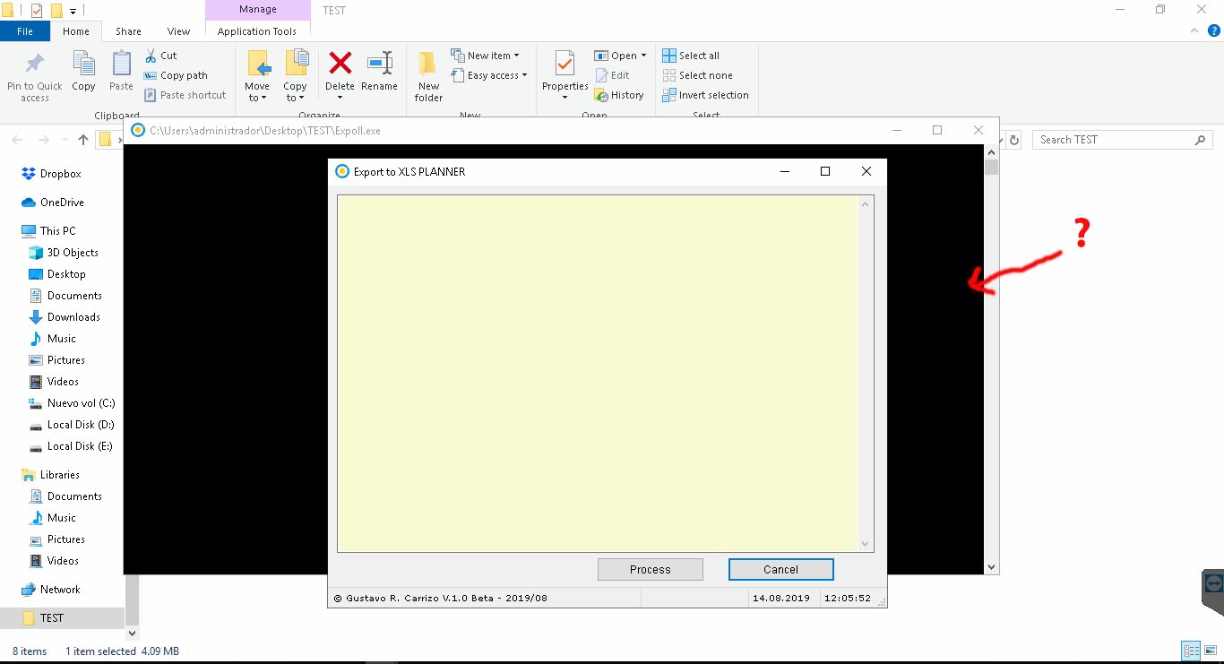

I made an application based on GRID2EXCEL that XLSXClass applies. It works without problem but, when I run it, a black window appears behind the application.
Possibly Alzheimer's does not allow me to discover what I did wrong.
Any ideas ?

To create apps console/mixed mode, you only need to add this followinq command (red color):
REQUEST HB_GT_WIN_DEFAULT (at top of your main prg file).
See example:
Function Main()
SetMode(25,80)
Cls
@ 10,10 Say 'Hello'
Alert('Hello')
Re: Black Window Background
Si , eso era , ahora recuerdo cuando recien comencé con Harbour y aun usaba el modo consola terminal .
Muchisimas Gracias por refrescar mi memoria.
Mi Alzheimer te lo agradece . Puede que algun dia me gradue del Kindergarden.
Yes, that was it, now I remember when I just started with Harbour and still used the terminal console mode.
Thank you so much for refresh my memory.
