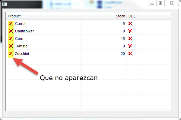

Hola,
Como puedo hacer que en la ultima columna de mi grid aparezca una imagen y que no salga en la primera columna.
Gracias
Hello,
How can I make an image appear in the last column of my grid and not appear in the first column?
Thank you

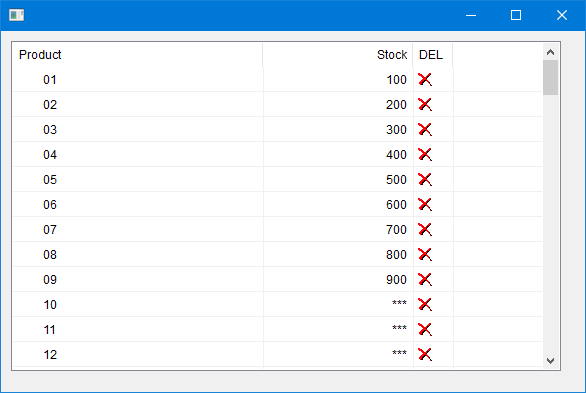

Bez tytułu.png (12.22 KiB) Viewed 2768 times

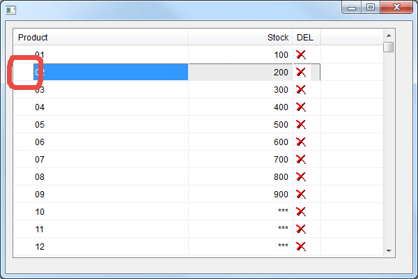

El espacio que queda en la primera columna, se puede eliminar?
Gracias
Can the space left in the first column be removed?
Thank you

AidTIC wrote: Fri Feb 22, 2019 6:33 pm El espacio que queda en la primera columna, se puede eliminar?
Gracias
Thank you
I think that it is impossible with the current Grid's imlementation in hmg.
But you can use the powerful TSBrowse library for your need.

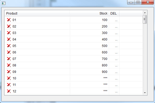

Please take a look for an image below
and a sample code is
// Browsing an array with TSBrowse
#include "TSBrowse.ch"
static Grid_1
   aItems := {}
   SET FONT TO "Arial", 10
   DEFINE WINDOW Form_1 ;
      WIDTH 600 ;
      HEIGHT 400 ;
      MAIN ;
      on init Test_Value()
      @ 10,10 TBROWSE Grid_1 ;
         ARRAY aItems;
         WIDTH 550 ;
         HEIGHT 330 ;
         HEADERS {'Product','Stock',"DEL"} ;
         WIDTHS {250,150,40};
         PICTURE '@K !xxxxxxxxxxxxxxxxx','@K 9999','' ;
         IMAGE "_No.bmp","_No.bmp";
         EDIT;
         CELLED;
         JUSTIFY { DT_CENTER, DT_RIGHT, DT_CENTER}
      WITH OBJECT Grid_1
         :SetAlign( 2, 1, DT_RIGHT )   // ( nCol, nLevel, nAlign )
         :SetColor( { CLR_FOCUSB }, { RGB( 51, 153, 254 ) } )
         :nLineStyle :=  LINES_NONE
         :nHeightCell += 6
         :nHeightHead += 8
      END WITH
   CENTER WINDOW Form_1
   ACTIVATE WINDOW Form_1
Procedure Test_Value
local x
   For x := 1 to 100
      ADD ITEM {  STRZERO( X , 2 ), x * 100 , 1 } TO Grid_1 OF Form_1
   Next x
   WITH OBJECT Grid_1
      :aColumns[ 3 ]:lBitMap   := .T.
      :aColumns[ 3 ]:lEdit     := .F.
      :aColumns[ 3 ]:lIndexCol := .F.
   END WITH
Hope that useful :idea:
