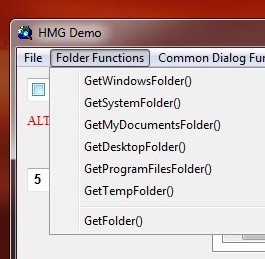

...\SAMPLES\Basics\MAIN_DEMO
This this is simplest way to call function.
