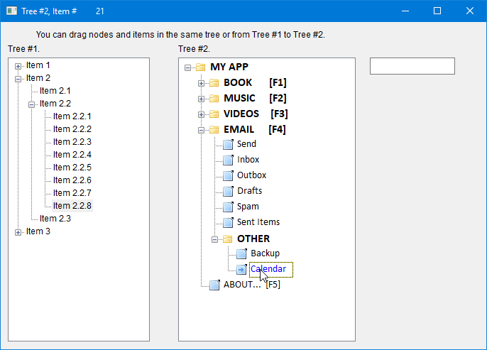

Hi Edward!
Can you put here small sample how to drag item from tree to textbox? I want to paste treeitem text to textbox and remember Id in another variable...
edk
Posts: 999
Re: Drag grid item to another grid
Post by edk »
No problem.
The ability to drag from TextBox to Tree_2 with the right mouse button has also been added.
DragAndDrop_0.005b.zip
(12.16 KiB) Downloaded 462 times
Drag tree and textbox.gif (53.13 KiB) Viewed 21113 times

I will soon try to add the possibility of moving the items of the tree so that you can freely set the order of their positions in the nodes. I'm thinking about using drag and drop with the Shift key for this purpose. Also, we will need a new InsertItem method that can be useful for other tasks. I'm still thinking about the possibility of defining a tree from scratch. Or maybe a dynamic context menu for any tree item/node, who knows :mrgreen: ?

As promised here is the next version.
Added:
- support for Ctrl and Shift while dragging and dropping.
With the Shift key, you can move items by changing the position in the tree, with the Ctrl key we perform a copy operation.
- handling the context menu when dropping the right mouse button on tree # 2 (Copy / Move)
- handling the context menu of tree # 2 (on the tree item/node: Rename / Delete / Add as child ; in the empty tree space: Add New As Root )
- there is a new method for the tree: InsertItem
As I did not integrate this method with HMG sources, we call it as a function: _InsertItem (ControlName, FormName, cValue, nInsertPos, [aImage], [Id]).
Now you can build a tree using the context menu. :)
DragAndDrop_0.006.zip
(18.31 KiB) Downloaded 471 times
Enjoy.
