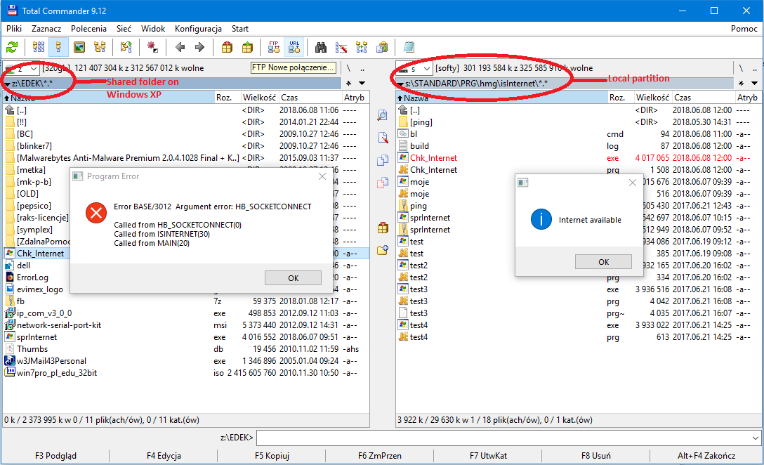

Hello all.
Issue refers to the situation when we run the program on Windows 10 v1803 from a mapped network resource shared on Windows XP or Linux (SMB1).
Since the release of Windows 10 v1803, some commands related to network sockets have stopped working. In general, the application has prohibited access to the Internet.
On some hb_ functions of the sockets written in C, the program crashes and on others it reports the error code 22 - EINVAL - an invalid argument.
I tried various options: "Run as Administrator", "Run in compatibility mode", I added a mapped network resource as a trusted Intranet. I turned off the Firewall on the host and client computers, unfortunately unsuccessfully.
Issue does not occur when you run the program from a local disk on Windows 10 v1803 or from a shared network resource on another Windows 10, Server 2008, etc.
Below is a short code that checks Internet connection using various methods.
The first two methods return no Internet connection, and the third crash.

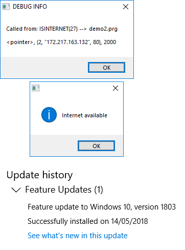

My OS is Windows 10 64 bit v1803
I am not facing any error running application

bpd2000 wrote: Fri Jun 08, 2018 12:33 pm Dear Edward,
Yes, if you are running a file from a local disk or from a shared network resource on another Windows 10, Server 2008, 2012.
But try to run from a mapped drive that has been shared on Windows XP ;)
