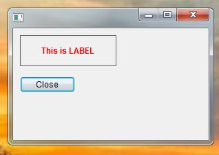

Can somebody know why WM_MOUSELEAVE message is not generated for LABEL and another controls?
Example of code:
MEMVAR _HMG_SYSDATA
FUNCTION Main()
  DEFINE WINDOW MainForm;
    WIDTH  300;
    HEIGHT 200;
    MAIN
    DEFINE LABEL Label1
      ROW       10
      COL       10
      WIDTH     140
      HEIGHT    45
      VALUE     "This is LABEL"
      ALIGNMENT Center
    END LABEL
    DEFINE BUTTON CloseButton
      ROW     70
      COL     10
      WIDTH   80
      HEIGHT  23
      CAPTION "Close"
      ACTION  MainForm.RELEASE
    END BUTTON
  HMG_ChangeWindowStyle(MainForm.Label1.HANDLE, 0x00800200 /*WS_BORDER|SS_CENTERIMAGE*/, NIL, .F., .T.)
  EventCreate("LabelEventHandler", MainForm.Label1.HANDLE)
  MainForm.CENTER
  MainForm.ACTIVATE
FUNCTION LabelEventHandler()
  STATIC lTracking := .F.
  LOCAL  nHWnd := EventHWND()
  LOCAL  nMsg  := EventMSG()
  SWITCH nMsg
    CASE WM_MOUSEMOVE
      IF ! lTracking
        MainForm.Label1.FONTCOLOR := {255, 0, 0}
        MainForm.Label1.FONTBOLD  := .T.
        lTracking := TrackMouseEvent(nHWnd, 0x00000002 /*TME_LEAVE*/)
      EXIT
    CASE WM_MOUSELEAVE
      MainForm.Label1.FONTCOLOR := {0, 0, 0}
      MainForm.Label1.FONTBOLD  := .F.
      lTracking := .F.
      EXIT
  ENDSWITCH
#pragma BEGINDUMP
#include <windows.h>
#include "hbapi.h"
#include "HMG_UNICODE.h"
HB_FUNC( TRACKMOUSEEVENT )
  TRACKMOUSEEVENT tmi;
  tmi.cbSize      = sizeof(TRACKMOUSEEVENT);
  tmi.dwFlags     = hb_parni(2);
  tmi.hwndTrack   = (HWND) HMG_parnl(1);
  tmi.dwHoverTime = HOVER_DEFAULT;
  hb_retl(TrackMouseEvent(&tmi));
#pragma ENDDUMP
Re: mouseover label
KDJ wrote: Sat Jun 09, 2018 8:09 pm Can somebody know why WM_MOUSELEAVE message is not generated for LABEL and another controls?
Thanks, good question
gfilatov
Posts: 1090
Location: Ukraine
Re: mouseover label
Post by gfilatov »
Add SS_NOTIFY style to your Label definition :idea:
Hope that helps.
KDJ
Posts: 243
Re: mouseover label
Post by KDJ »
Hi, Grigory
MSDN wrote: SS_NOTIFY
Sends the parent window STN_CLICKED, STN_DBLCLK, STN_DISABLE, and STN_ENABLE notification codes when the user clicks or double-clicks the control.
So applying SS_NOTIFY style should not affect the WM_MOUSELEAVE message generation.
In addition, this LABEL already has SS_NOTIFY style:
0x50800301 == WS_CHILD | WS_VISIBLE | WS_BORDER | SS_CENTERIMAGE | SS_NOTIFY | SS_CENTER
There must be some other reason that WM_MOUSELEAVE is not received.
gfilatov
Posts: 1090
Location: Ukraine
Re: mouseover label
Post by gfilatov »
KDJ wrote: Sun Jun 10, 2018 12:19 pm this LABEL already has SS_NOTIFY style:
You are right!
Please take a look for an updated sample below:
FUNCTION Main()
    WIDTH  300;
    HEIGHT 200;
    MAIN ;
    ON MOUSEMOVE (MainForm.Label1.FONTCOLOR := {0, 0, 0}, MainForm.Label1.FONTBOLD := .F., lTracking := .F.)
    DEFINE LABEL Label1
      ROW       10
      COL       10
      WIDTH     140
      HEIGHT    45
      ALIGNMENT Center
    END LABEL
      ROW     70
      COL     10
      WIDTH   80
      HEIGHT  23
      CAPTION "Close"
    END BUTTON
  MainForm.CENTER
  MainForm.ACTIVATE
  SWITCH nMsg
    CASE WM_MOUSEMOVE
      IF ! lTracking
      EXIT
    CASE WM_MOUSELEAVE
      lTracking := .F.
      EXIT
  ENDSWITCH
#pragma BEGINDUMP
#include "hbapi.h"
#pragma ENDDUMP
Just idea. :idea:
Re: mouseover label
gfilatov wrote: Sun Jun 10, 2018 3:42 pm ...
OK :arrow:
Thanks Grigory and KDJ 8-)
Happy HMG'ing
KDJ
Posts: 243
Re: mouseover label
Post by KDJ »
Grigory
Yes, thank you for the idea.
This can also be done by processing WM_SETCURSOR message in main window event handler (example is here: viewtopic.php?f=9&t=4806&hilit=mouse+andyglez ).
But WM_MOUSELEAVE is still not received.
Why WM_MOUSELEAVE in HMG Extended works and in classic HMG doesn't work?
