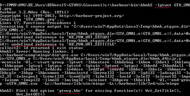

Does anyone tried / tested samples in wonderful tutorial for GTWVG by wonderful documenter - developer Giovanni Di Maria ?
If so, I need a bit help on this issue :
I couldn't build that samples :(
How I can add a .hbc file to the project :?
TIA

Hello friend esgici
Look at the sample
viewtopic.php?f=33&t=5633&p=55054&hilit=mustafa#p55054
GTWvg_Sample_New.zip
Very important in the folder that you do for
Our application must be "hbmk.hbm"
Build.bat
@ECHO OFF
call c:\hmg.3.4.4\build.bat Main %*

Muchas gracias hermano Mustafa :D
