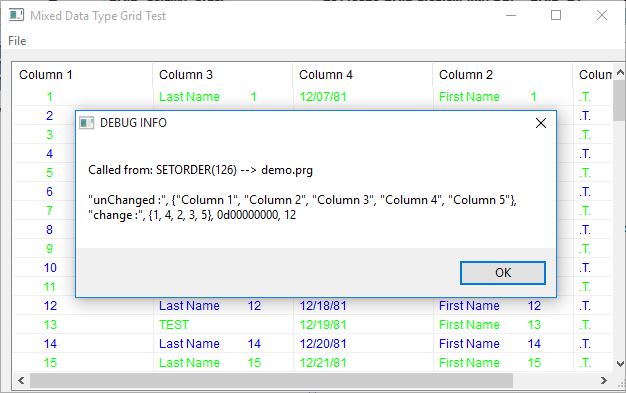

Dear Sirs,
On the Grid Column Order sample modified for virtual grid and dbf,
this is what i found : return the wrong value with Form_1.Grid_1.cell( 1,2)
ColumnOrder unChanged and wrong value extracted.JPG (49.24 KiB) Viewed 4031 times
GRID_Column_Order.zip
(3.01 KiB) Downloaded 350 times
TIA
best rgds,
Chang

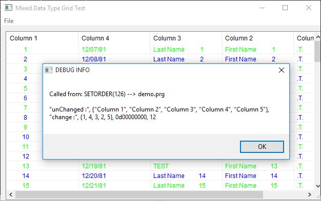

setting local i, aColumns := { 1, 4, 2, 3, 5}
this is what we get
