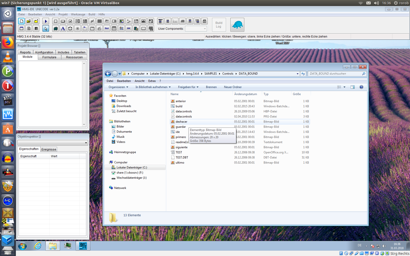

Hi Alan, take a look at DATA_BOUND in the samples, the screenshot shows the path in your installation-folder. I fancy you could use it for your app.
- databound.png (920.9 KiB) Viewed 5030 times

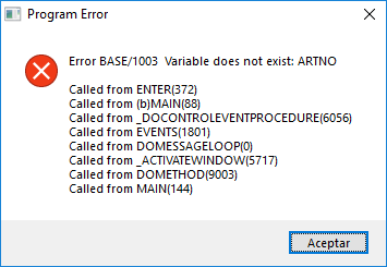

Re: Variables and Definition Errors
Hola asharpham
From the outset, your program showed me the following error message
Hice algunas correcciones a tu programa para hacerlo funcional
los comentarios vienen dentro del programa
I made some corrections to your program to make it functional
the comments come within the program
De entrada, me desplegó los siguientes mensaje de errorThis program is unfinished so not all of the menu buttons work. It loads the main menu and loads "Add New Music" but none of the other menu items work, as well as the 3 buttons at the bottom. Some of the labels aren't displaying properly either but I know I can fix that as I work on it.
