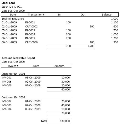

Please attach file, is there example to make report like this.
