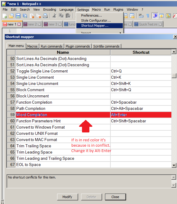

I got to include several tags that will be very useful, some few are in Harbour and most in HMG. As was mentioned in the video, use the Quicktext to reproduce examples of components such as: MAIN WINDOW BUTTONS, Grid, COMBOBOX, etc ... These tags are in UPPER case, because I really like to use CamelCase my editions. But if the use of the TAB is bothering you, can replace by ALT + ENTER combined keys at Settings \ Shortcut mapper \ Plugin commands TAB (Replace Tag item) or you can change tags from UPPER to lower case as you wish because all entries are in sensitive case. ;)

Important note: Some time there is a conflict with Alt-Enter hotkeys that probably was reserved for other functions of NPP. In case is not working properly, please check if is in red color in Settings/Shortcut mapper and change it.
