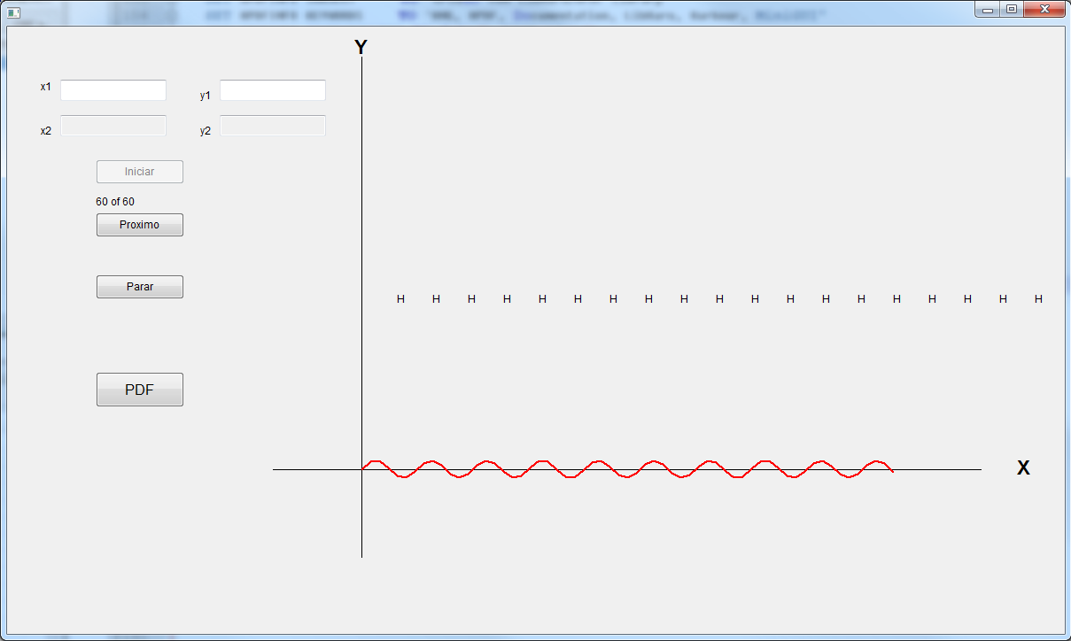

I have a graph on the screen created with draw line I need to generate this graph in a pdf file I'm trying HPDFPRINT LINE without success
draw line in at x1,x2 to y1,y2
@ row ,col hpdfprint line to tRow , tCol
Jair Pinho
HMG ALTA REVOLUÇÃO xBASE
HMG xBASE REVOLUTION HIGH
http://www.hmgforum.com.br

check my code
tendencia.zip
(1.71 KiB) Downloaded 716 times

I need the pdf to be the same as the lines generated with draw line
