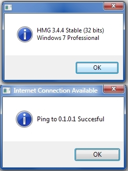

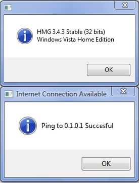

bpd2000 wrote: Wed Jun 21, 2017 12:13 pmI confirm same result as posted by EDK
Well, it turns out that this func works ok on xppro and windows10 but not on win7 and vista.
bellow are my tests on xp,win7,vista:
So, it seems that everybody's right!
(yes I know, that's a rare fact, but sometimes happens, --and this time thanks to MS's inconsistency between different Win versions... ;))
Interestingly, it seems that win10 'mimics' winxp, that is: "two-steps-back compatibility"
or ... a 'revolutionary' approach of the basic evolution rules. Spectacular!
(now the problem is to find where exactly the problem comes from:
is it the function or windows -and if the later, which version?
too bad that i'm not willing to spend more life-time to find it out.)
regards,
Pete
Re: Internet connected or not
PeteWG wrote: Thu Jun 22, 2017 7:25 am
Pete
Check Google Public DNS IP address 8.8.8.8 or 8.8.4.4 instead of 0.1.0.1
You may get ping successful of 0.1.0.1 , but you can not surf the web
Another test is verifying you can surf the web when you get ping successfully
