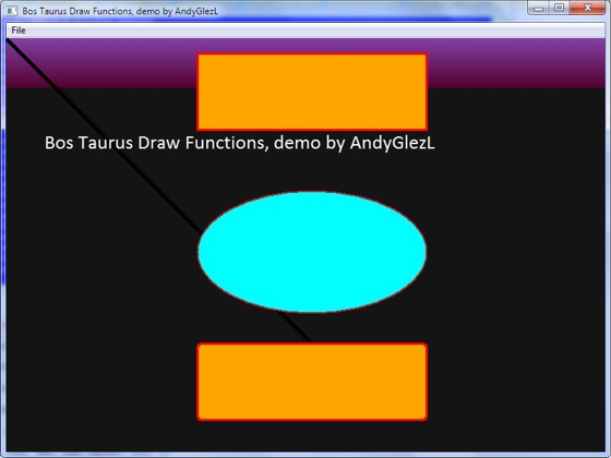

Re: Re Bos aurus Demo7 , an Ellipse question
Bueno, aquí un simple ejemplo de como lo hago yo.
espero les sirva...
Well, here's a simple example of how I do it.
I hope it works for you
FUNCTION MAIN()
PUBLIC  cText := "Bos Taurus Draw Functions, demo by AndyGlezL"
SET CODEPAGE TO SPANISH
    DEFINE WINDOW Win1 AT 0,0 WIDTH  800  HEIGHT 600  TITLE  cText MAIN
        DEFINE MAIN MENU
            DEFINE POPUP "File"
                MENUITEM "Create Bitmap" 	ACTION CreaBitmap()
                MENUITEM "Exit" 			ACTION Win1.Release
            END POPUP
        END MENU
		@ 000,000 IMAGE Image_1 OF Win1 PICTURE "" WIDTH BT_ClientAreaWidth( "Win1" ) HEIGHT BT_ClientAreaHeight( "Win1" ) // STRETCH
   CENTER WINDOW Win1
   ACTIVATE WINDOW Win1
RETURN Nil
FUNCTION CreaBitmap()
	LOCAL hDC, BTstruct, hBitMap, nRen := 120, nCol := 50
	hBitMap  := BT_BitmapCreateNew( BT_ClientAreaWidth( "Win1" ), BT_ClientAreaHeight( "Win1" ), { 020, 020, 020 } )
	hDC := BT_CreateDC( hBitMap, BT_HDC_BITMAP, @BTStruct )
	BT_DrawGradientFillVertical( hDC, 000, 000, BT_ClientAreaWidth( "Win1" ), 65, { 130, 065, 163 }, { 083, 000, 048 }  )
	BT_DrawLine( hDC, 1, 0, 500, 500, BLACK , 5 )
	BT_DrawText( hDC, nRen, nCol, cText, "Calibri", 20, WHITE, WHITE, BT_TEXT_TRANSPARENT, BT_TEXT_LEFT, BT_TEXT_NORMAL_ORIENTATION )
	BT_DrawFillRectangle(hDC,  20, 250, 300, 100, ORANGE, RED, 3)
	BT_DrawFillRoundRect(hDC, 400, 250, 300, 100, 10, 10, ORANGE, RED, 3)
	BT_DrawFillEllipse(hDC, 200, 250, 300, 160, CYAN, BROWN, 2)
	BT_DeleteDC( BTstruct )
	BT_BitmapSaveFile( hBitmap, "Sample.JPG", BT_FILEFORMAT_JPG )
	BT_BitmapRelease( hBitmap )
	SetProperty( "Win1", "Image_1", "Picture", "Sample.JPG" )
	BT_ClientAreaInvalidateAll( "Win1", .F.)

Thanks for he response, but I still do not understand where the ellipse coordinates come from.
Andy's code specifies a window of 800 X 600 which has a center of row 300 column 400. yet the ellipse
coordinates are row 200 column 250., .... not anywhere near the window center. Pls explain.
Thanks
Bien, ya entendí la pregunta... :oops:
Las coordenadas de la elipse 200,250 aplican igual que las demás funciones
RenIni, ColIni TO RenFin, ColFin fijate en las coordenadas de los rectangulos
y veras la relación.
Well, I already understood the question ...: :oops:
The coordinates of the 200,250 ellipse apply the same as the other functions
RenIni, ColIni TO RenFin, ColFin Note the coordinates of the rectangles
And you will see the relationship.

To those who offered help, thanks
My main problem turned out to be the interpretation of the row and column coordinates. I assumed that you would specify the center point
followed by the size parameters. Wrong! BTaurus means the coordinates of the upper left corner of a rectangle that surrounds the ellipse.
You can verify by drawing a rectangle along with the ellipse using the same values.
Everything clear now re this post subject.
