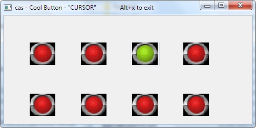

I've added a small form template with flat design using ButtonEX. It can be compiled only with MiniGUI but i've included the exe file in case someone just wants to check it out.
Hace tiempo, con este ejemplo hice algo parecido en HMG.
Long ago, with this example I did something similar in HMG.
CAS-Cool Button.jpg (64.01 KiB) Viewed 6437 times
Pruebas CAS MiniGui.rar
(3.07 KiB) Downloaded 262 times
