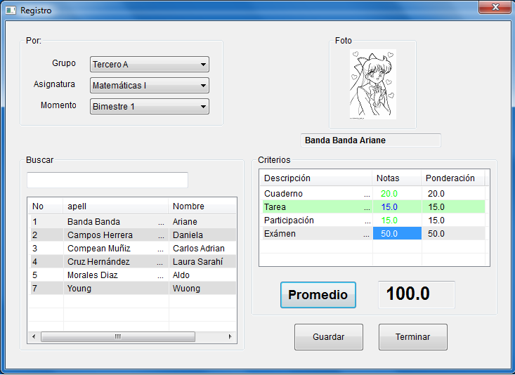

Modifiqué un poco el código del demo39 porque necesitaba salir de la edición del grid con un simple ENTER. Habrá una forma mas simple de hacerlo?
y mi otra duda: si en mi aplicación original hice el grid con el IDE cómo adecuar el On Key? , tambien el On Click en el script, por ejemplo:
Frm_sumativa.grid_2.On Click onclick() <---esto no me funciona
Hi all
I modified the demo39 code because I needed to exit the grid edit with a simple ENTER. Will there be a simpler way to do it?
And my other question: if in my original application I did the grid with the IDE how to adapt the On Key? , Also the On Click in the script, for example:
Frm_sumativa.grid_2.On Click onclick () <---this does not work

Thanks Gabor, they are 4 rows and in the last one must leave edition but if the user wants to return to modify, I added:
 function onkey()
      If this.cellrowindex= 4 .And. GetProperty("sample","Grid_1","Cellnavigation") = .T. .And. HMG_GetLastVirtualKeyDown () == VK_RETURN
       SetProperty("sample","Grid_1","Cellnavigation",.F.)
       Else
       SetProperty("sample","Grid_1","Cellnavigation",.T.)
     Endif
   return
But now I do not know what the syntax of the "On Key" is if the grid I did with the IDE
