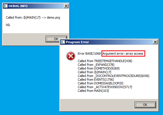

  • Error #1:
    At current DOC (at least in 3.4.4) says we can use This.TreeItemValue but if we change demo for:
    ITEM 'Expand Item' ACTION Form_1.Tree_1.Expand ( MsgDebug(This.TreeItemValue) )
    It will return this error:
    MsgDebug(This.TreeItemValue) should displays the current value at Tree item.
    This ID value could differs when is used ID (with ITEMIDS true and each due identification at all items) and when not used which it should return the tree item position at _HMG_aTreeMap.

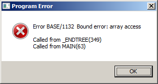

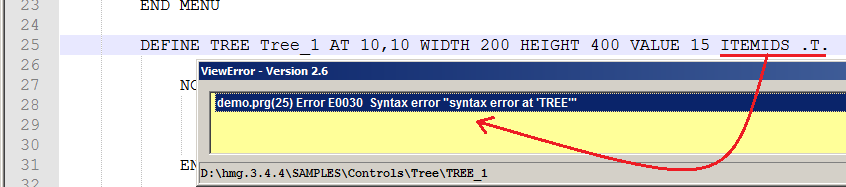

  • Error #2:
    According DOC at current version, ITEMIDS is a Tree property clause to switch when using for these USER's ID instead item position but if we change demo for:
    DEFINE TREE Tree_1 AT 10,10 WIDTH 200 HEIGHT 400 VALUE 156 ITEMIDS
    Even trying with another syntax, error comes again:

  2. i_tree.ch
    There are 4 ways to define TREE and the ITEMIDS clause has two ways that "will" confuse users because one way is with passing value :? and the other is not. I repeat: "will confuse" (in the future tense) because this option is new and apparently no one used before because otherwise would accuse the same error that I reported. So I decided to normalize (leaving as a SWITCH) the four TREE modes for: Standard Syntax, Alternate Syntax, Standard and Extended:

    Note that in two situations this was changed:
    [ ITEMIDS <itemids> ]
    For this:
    [ <itemids : ITEMIDS> ] as corrected.

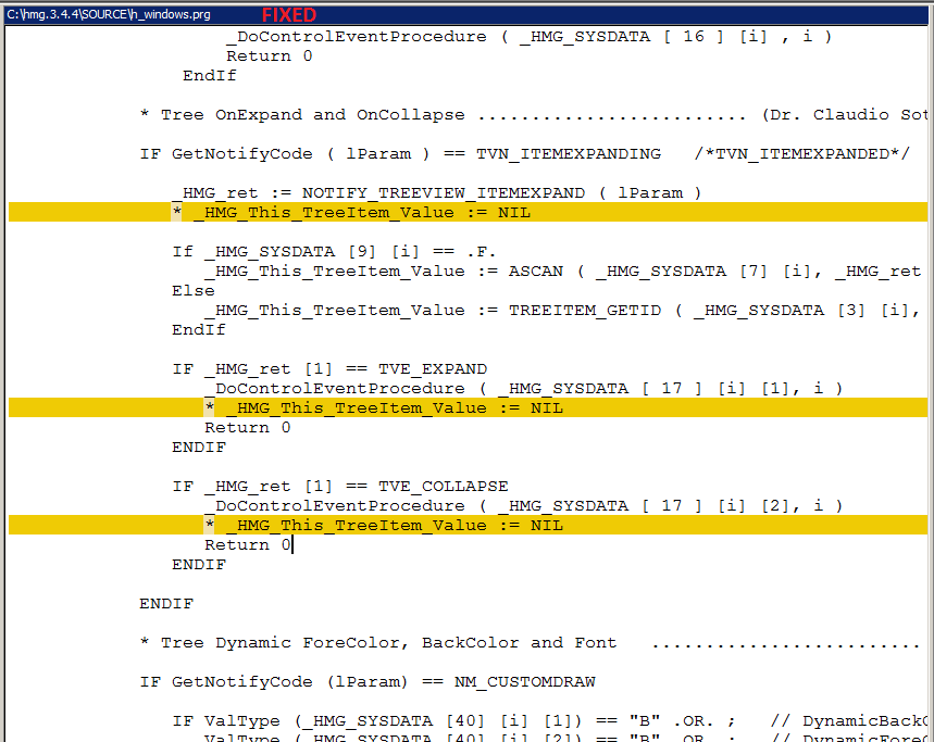

  3. h_windows.prg
    As I was asked to Dr. Claudio, I was able to prove for myself that the value error of the TREE item comes wrongly at Expand and Collapse events and because I also see no reason to annul its value. So I decided to disable the lines where the _HMG_This_TreeItem_Value is wrongly assigned with NIL value:
    * Tree Processing .....................................

    * Tree OnExpand and OnCollapse ......................... (Dr. Claudio Soto, July 2014)
    IF GetNotifyCode ( lParam ) == TVN_ITEMEXPANDING   /*TVN_ITEMEXPANDED*/
       _HMG_ret := NOTIFY_TREEVIEW_ITEMEXPAND ( lParam )
       * _HMG_This_TreeItem_Value := NIL
       If _HMG_SYSDATA [9] [i] == .F.
          _HMG_This_TreeItem_Value := ASCAN ( _HMG_SYSDATA [7] [i], _HMG_ret [2] )
       Else
          _HMG_This_TreeItem_Value := TREEITEM_GETID ( _HMG_SYSDATA [3] [i], _HMG_ret [2] )
       EndIf
       IF _HMG_ret [1] == TVE_EXPAND
          _DoControlEventProcedure ( _HMG_SYSDATA [ 17 ] [i] [1], i )
          Return 0
       IF _HMG_ret [1] == TVE_COLLAPSE
          _DoControlEventProcedure ( _HMG_SYSDATA [ 17 ] [i] [2], i )
          Return 0

    Please search for * _HMG_This_TreeItem_Value that I already disable it.

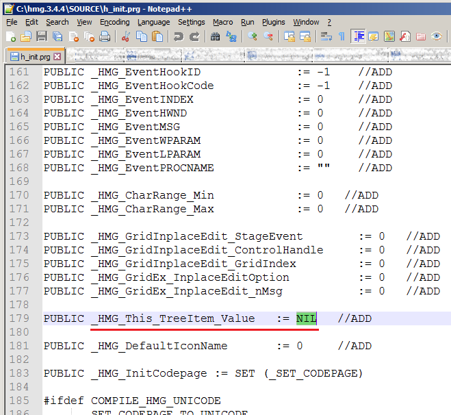

  4. h_init.prg
    There is no sense to create a _HMG_This_TreeItem_Value with NIL value because TREE ID always start at least with one item.
    So the initial value must to be to 1 then the error disappeared when I set the TREE.
    Originally it was:
    And changed by this:
    PUBLIC _HMG_This_TreeItem_Value   := 1     //ADD
I tested all TREE samples with new patch and all seems working properly.

		DEFINE TREE Tree_1 AT 10,10 WIDTH 200 HEIGHT 400 VALUE 15 ITEMIDS
			NODE 'Item 1'
				TREEITEM 'Item 1.1'
				TREEITEM 'Item 1.2' ID 999
				TREEITEM 'Item 1.3'
			END NODE
			NODE 'Item 2'
				TREEITEM 'Item 2.1'
				NODE 'Item 2.2'
					TREEITEM 'Item 2.2.1'
					TREEITEM 'Item 2.2.2'
					TREEITEM 'Item 2.2.3'
					TREEITEM 'Item 2.2.4'
					TREEITEM 'Item 2.2.5'
					TREEITEM 'Item 2.2.6'
					TREEITEM 'Item 2.2.7'
					TREEITEM 'Item 2.2.8'
				END NODE
				TREEITEM 'Item 2.3'
			END NODE
			NODE 'Item 3'
				TREEITEM 'Item 3.1'
				TREEITEM 'Item 3.2'
				NODE 'Item 3.3'
					TREEITEM 'Item 3.3.1'
					TREEITEM 'Item 3.3.2'
				END NODE
			END NODE
		END TREE

I sorry to say but I think I have explained very well and with rich informations to receive this your response. :shock:
Re: TreeItemValue bug
I'm sorry Pablo but there is not much to add to what I already expressed, outside the some events This.TreeItemValue is nil and this behavoir is right because is not available.
Here:
You use This.TreeItemValue with the Expand method, bud This.TreeItemValue is valid inside of ON EXPAND event.
srvet_claudio wrote: Fri Apr 28, 2017 12:45 am I'm sorry Pablo but there is not much to add to what I already expressed, outside the some events This.TreeItemValue is nil and this behavoir is right because is not available.
Here:
But before I changed, these values were always NIL and by the current HMG code it's forcing to NIL. Why to force ? :?
I will prepare a simple to demonstrate my frustation with original code at expandig and collapse nodes.
When I click to "+" or to "-", images are not duly displayed. What I want is to displaying an open folder picture when is expading event.
And display a closed folder when is collapsed. I have check and pretty sure of event is working well with these indicated codes.
I am in my third day in this and I wish to be approved because is working for me now with these patches.
Otherwise I will need to create my own tree, my ownevent, my own include file. So, why this ?
Redarding ITEMIDS clause must it working and for me these indicated patches are pretty working well.
Is that what I want. To tell me that I am wrong and let us known what is wrong in these indicated patches.
Is it posible ?
edk

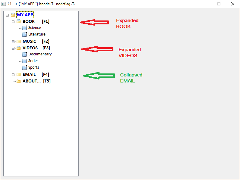

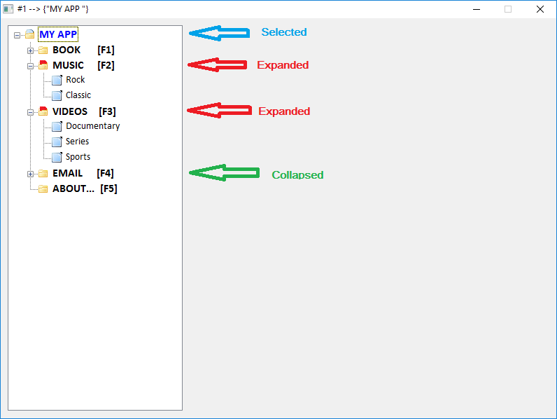

Pablo César wrote: Fri Apr 28, 2017 10:58 am When I click to "+" or to "-", images are not duly displayed. What I want is to displaying an open folder picture when is expading event.
Pablo, maybe try this way:
ON EXPAND Form_1.Tree_1.ImageIndex(This.TreeItemValue):={1,1};
ON COLLAPSE Form_1.Tree_1.ImageIndex(This.TreeItemValue):={0,1};
Bez tytułu.png (15.76 KiB) Viewed 18274 times
You can also make different icons for expanded and selected node:
In this case you should add new image for expanded node:
Form_1.Tree_1.AddImage:="folder_expand.gif"
ON Expand change to:
ON EXPAND Form_1.Tree_1.ImageIndex(This.TreeItemValue):={4,1};
Generally tree images are stored under indexes:
NODEIMAGES unSelected = 0
NODEIMAGES Selected = 1
ITEMIMAGES unSelected = 2
ITEMIMAGES Selected = 3
Each other image added will receive another index numer.
for example:
NODEIMAGES { "folder.gif", "folder_page.gif" };
ITEMIMAGES { "Page.gif",   "page_next.gif"   };
"folder.gif" = 0
"folder_page.gif" = 1
"Page.gif" = 2
"page_next.gif" = 3
"folder_expand.gif" = 4
Bez tytułu2.png (14.98 KiB) Viewed 18252 times
Hi Edward,
The solution I have already found and I have not any doubt about it.
Thank you for your indication and interest to help me. But as I have already explained the problem it is others things.
In summary, what I maintain is: wrong attrib at HMG event + bad clause used for ITEMIDS + bad function to locate ID + _HMG_This_TreeItem_Value wrong declared value.
I will explain in the practice, probably I will get better sucess to make me understand by it.
I attach the following demos and please make the favor you Edward, you Claudio and who else can be so kind into test it and revert with your opinions if I am wrong or not in what I'm saying...
Here are two executables:
-One with name Demo2.exe and have it been builded with 3.4.4 originally (not patched).
-Another is Demo2_Patched.exe and have it been builded with already patched in the HMG core. In other words: with HMG altered in the code of TREE which demands with according my previous indication (pls read my first msg attentively).
Remark: When I said patched, is to be applied all my recomendations.
TREE_2.rar
Demos pack for testing proposes
(2.42 MiB) Downloaded 563 times
Please compare the behaviour of both executables files when you click on "+" and "-". You will see the picture doesn't change. :|
I know there is a way to forces it to the due image changing. But you will note that Demo2.exe it's not working properly. Check always node's IMAGE and STATUSBAR to reach what I am saying.
Please somebody let me know if I am wrong or not.
Thank you Edward for your interest and thanks to anybody who is interested to solve TREE problem too. But need thecnical feedback (with details in what I am doing wrong) and what can be do for improving this problem in TREE value.
Sorry if my words in English appear to be repeated. My English is not so good. But I hope that in practice (in code language) it can facilitate understanding.
Wating for yours comments gentlemen.
Hi Pablo,
I ran both and only statusbar is different! One says 8 On Change and the other NIL
Images are OK.
Thank you Serge for you feeding back. It's what I wanted to know.
Images are not changing in this example, because I not applied the Edward suggestions.
This is ok, for me because I can drive this thru the same value which is being displayed at STATUSBAR. But this value MUST be correct value. Andt how to make it right when these events attrib wrongly the value for TreeItemValue ? That's my main questioning to Claudio. Probably I need to write in Spanish to make me understanding... :oops: (As somebody said: I know nothing... :lol: :lol: My English is so bad).
TreeItemValue can not be NIL ! Am I right ?
