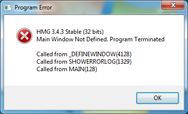

Hi Pablo
Sorry for replying late.
I could not run your latest build of viewError on my laptop with win7 professional 32 bits.
I compiled it in 32 bits when I ran the program I got the following message.
Pls check
Thanks
Re: ViewError - HMG building utility
Rajeev,
This your HMG version 3.4.3 has already all the patches be applied ?
Since Threads HMG version, Main Windows are not required...
When you talk about run your latest build (error in your compilation), you refer to any compilation of "your project" or a compilation of ViewError itself ? :? (I'm confussed now).
Because this error doesn't happen here...

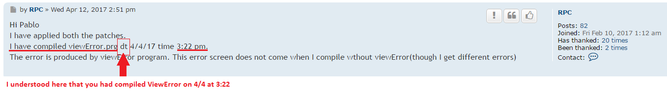

I have compiled viewError.prg dt 4/4/17 time 3:22 pm.
The error is produced by viewError program. This error screen does not come when I compile wthout viewError(though I get different errors)

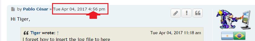

Hello Rajeev,
RPC wrote: Wed Apr 12, 2017 5:51 pm I have compiled viewError.prg dt 4/4/17 time 3:22 pm.
So It's means you are not using the last ViewError version. Now it's version # 2.6.
This your compilation date/time is ahead of last release. How It could ?
Because I published at 4:56 pm.
So it could never be at this time the due the same ViewError we talking about... even thinking in time zone difference (Brazil to India). India is ahead of the time zone with Brazil. I am really confused. :?

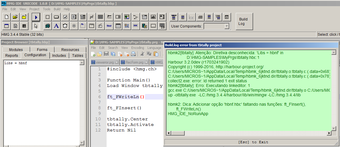

Hi Pablo
* I have downloaded the source and exe file from your post dt Tue Apr 04, 2017 7:56 pm. The date and time(modified) of ViewError.prg is 4/4/17 and 3.22 pm. Pls check.
* Error.log file
hbmk2[tbtally]: Warning: Unknown directive: 'libs = hbnf' in
D:\HMG-SAMPLES\MyPrgs\tbtally.hbc:1
Harbour 3.2.0dev (r1601151502)
C:/Users/SPC/AppData/Local/Temp/hbmk_74hb83.dir/tbtally.o:tbtally.c:(.data+0x228): undefined reference to `HB_FUN_FT_FINSERT'
C:/Users/SPC/AppData/Local/Temp/hbmk_74hb83.dir/tbtally.o:tbtally.c:(.data+0x248): undefined reference to `HB_FUN_FT_FWRITELN'
hbmk2[tbtally]: Error: Running linker. 1
gcc.exe C:/Users/SPC/AppData/Local/Temp/hbmk_74hb83.dir/tbtally.o C:/Users/SPC/AppData/Local/Temp/hbmk_74hb83.dir/hbmk_x8rbej.o "D:/HMG-SAMPLES/MyPrgs/_temp.o" -mwindows -Wl,--start-group -lhmg -lcrypt -ledit -leditex -lgraph -lini -lreport -lhfcl -lmsvfw32 -lvfw32 -lhbct -lhbwin -lhbmzip -lminizip -lhbmemio -lhbmisc -lhbmysql -lmysql -lhbtip -lsqlite3 -lhbsqlit3 -lsddodbc -lrddsql -lsddmy -lhbodbc -lodbc32 -lhbhpdf -lhbfimage -lhbpgsql -lhbnetio -lxhb -lpng -llibhpdf -lhbvpdf -lhbzebra -lhbextern -lhbdebug -lhbvmmt -lhbrtl -lhblang -lhbcpage -lgtcgi -lgtpca -lgtstd -lgtwin -lgtwvt -lgtgui -lhbrdd -lhbuddall -lhbusrrdd -lrddntx -lrddcdx -lrddnsx -lrddfpt -lhbrdd -lhbhsx -lhbsix -lhbmacro -lhbcplr -lhbpp -lhbcommon -lhbmainwin -lkernel32 -luser32 -lgdi32 -ladvapi32 -lws2_32 -liphlpapi -lwinspool -lcomctl32 -lcomdlg32 -lshell32 -luuid -lole32 -loleaut32 -lmpr -lwinmm -lmapi32 -limm32 -lmsimg32 -lwininet -lhbpcre -lhbzlib -Wl,--end-group -otbtally.exe -LC:/hmg.3.4.3/harbour/lib/win/mingw -LC:/hmg.3.4.3/lib
hbmk2: Hint: Add option 'hbnf.hbc' for missing function(s): ft_FWriteLn(),
ft_FInsert()
Now we know what the error is about hbnf. Always the main reason is: the given poor info... :|
I prepare this project, same name, same folder, and is quite empty program but it serves enough for compiling.
Take this I try to compile:
MyPrgs.rar
Source files empty project
(720 Bytes) Downloaded 351 times
Certainly, the compiling error did not make happen. Am I right ?
No compilation errors ? Do you want to know where is your error in
Now lets return to VoewError interests...
You say that ViewError does not work for you...
I do not know where did you mistake:
  1. Last version ViewError used
  2. At ViewError installation
  3. if you changed something and you have not informed us yet...
See picture below and note I was able to reproduce the same error as yours:
Sorry to say, but I am totally confused with everyting you said.

* Your ViewError.prg has date 4/4/17 and time 3:22 pm
Your VieWrror.exe has date 4/4/17 and time 4:56 pm
Your post which contains the above two is 4/4/17 and time 7:56 pm
which is all perfectly logical and correct. There is no confusion at all.
I have downloaded the ViewError.prg and ViewError.exe mentioned in your post dated 4/4/17 at 7:56 pm. That is the latest viewError prg and exe you have posted and I have used.
