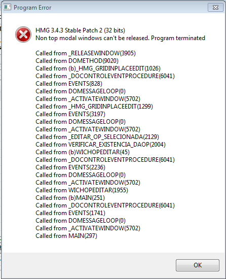

8-) Hi to all,
I am trying to move from HMG 3.3.1 to HMG 3.4.3 but I am having some problems:
1) Missing DLL file ( never been needed).
Libwinpthread-1.dll it is located at C:\hmg.3.4.3\MINGW\i686-w64-mingw32\lib\
2) Problem with HMG_GridInPlaceEdit().
Once opened, the editing window does not close anymore, neither pressing ESC nor pressing ENTER or when it loses focus, it remains
open and generates a runtime error.
Any ideia about this issue ?
[]´s Salamandra

Did you download HMG 3.4.3 and apply patch 2 or did patch 2 apply to an older version of HMG? Look inside of you build.bat file if the hbmk2 take the directive -ldflag="-pthread -static -lpthread" ? You need all compilers of HMG.3.4.3 for this patch.

Hi Dr Claudio,
Thanks for your help.
I downloaded HMG3.4.3, applied Patch 1, applied Patch 2 and then rebuild all libs (32 bits).
I am using HMG Ide for small programs and QPM 5.5.0004 for bigger programs (faster building) and
both the builds report the same problem.
This is actual Build.bat:
