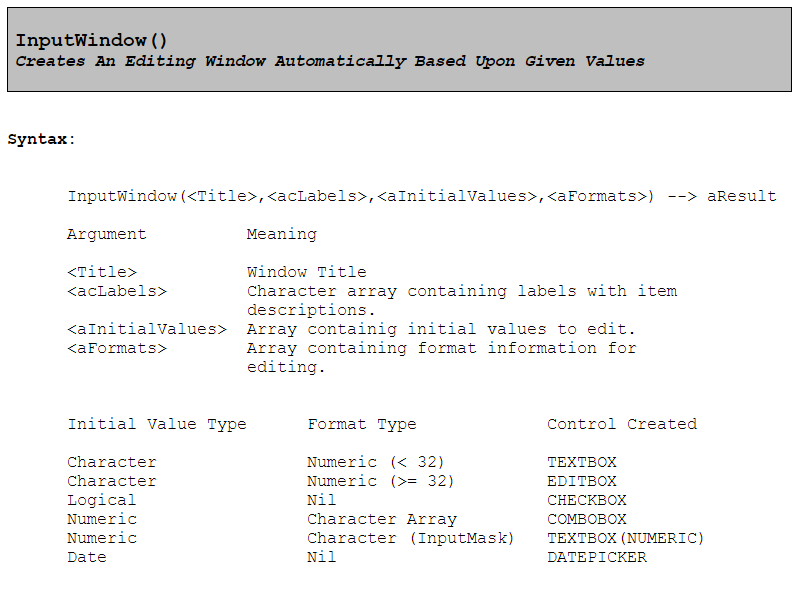

This is clearly indicated in the documentation:

It does not work because you filled incorrectly formats array:
albl :={'Texto','Numero','Fecha','Logico'},;
aVal :={'',1000,date(),.t.},;
// INCORRECT: aFrm :={NIL, '999,999', NIL, NIL}
// OK:        aFrm :={16, '999,999', NIL, NIL}
For an initial character value you must specify a number in format indicating maxlength.

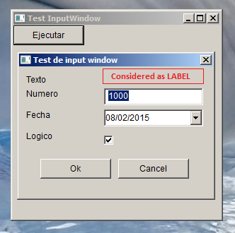

Now in this new release in HMG 3.4.0, InputWindow has improved. This kind of posible mistake is treated internally by InputWindow() to prevent this error.
So you can take this same code, build it with HMG 3.4.0 and will see is going to work without runtime error.
The example was executed but without the first field. Because InputWindow interpreted as a LABEL by the reason aFormats value is NIL.
This running will show clearly to the user when wrong parameter be passed on.
