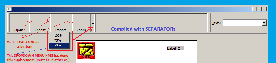

Hi Claudio,
When defined DROPDOWN MENU owned at an button in ToolBar is not being positioned in the right position.
It should be just underneath of the button item but is not when SEPARATORs been defined... :|

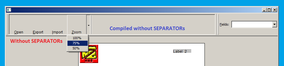

But this is without SEPARATORs... :cry:
This I supposed to be due DROPDOWN MENU has not considered the amount of SEPARATORs been defined. It should increases width size of each SEPARATOR and set to COL of DROPDOWN MENU.
I do not know if there is any function that I can move the DROPDOWN MENU manually.
Aesthetically it gets very strange the menu displacement and the worse I love to use SEPARATOR on each button especially when it is inside a SPLITBOX.

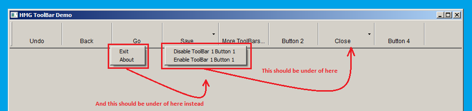

You will see dropdown menus, will looks like this:
And never mind if is themed window or not.
I have exaggerated with many SEPARATORs, just for showing you what I mean.
