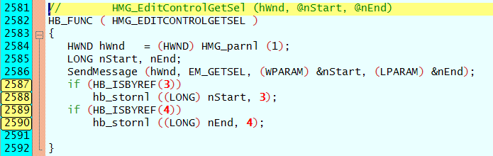

HMG_EditControlGetSel(nHWnd, @nStart, @nEnd) - does not work properly.
Why?
Look at source code:
How to fix it?
Use:
HMG_EditControlGetSel(nHWnd, NIL, @nStart, @nEnd)
or change in the source:
   if (HB_ISBYREF(2))
       hb_stornl ((LONG) nStart, 2);
   if (HB_ISBYREF(3))
       hb_stornl ((LONG) nEnd, 3);
