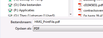

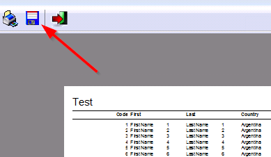

I use the PrintSystem sample distributed with the HMG release (c:\hmg.3.4.3\SAMPLES\PrintSystem). The only change is a modified (larger) DBF file. But to make it easy i will attach the complete folder (source, exe and DBF) to this post (printsystem.zip).
Everything seems to work well until i press the export button.
Then I browse to a folder and try to save the PDF file.
I press the save button ... and .... there is the error ...

I do not use images. The demo explains. The preview shows a text only report. Then i click export and save the PDF file.
Cay you use the demo in my last post and post the exported PDF ?

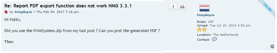

Report PDF export function does not work HMG 3.3.1
Thank for your answers. I surely used your example.
I would not say it worked for me without having tested your example ...
P.S. (Added later):
  • Sorry to be attached captured screen in my previous messages.
    I did this, because it was missing the message but now I see that you have redone the message.
