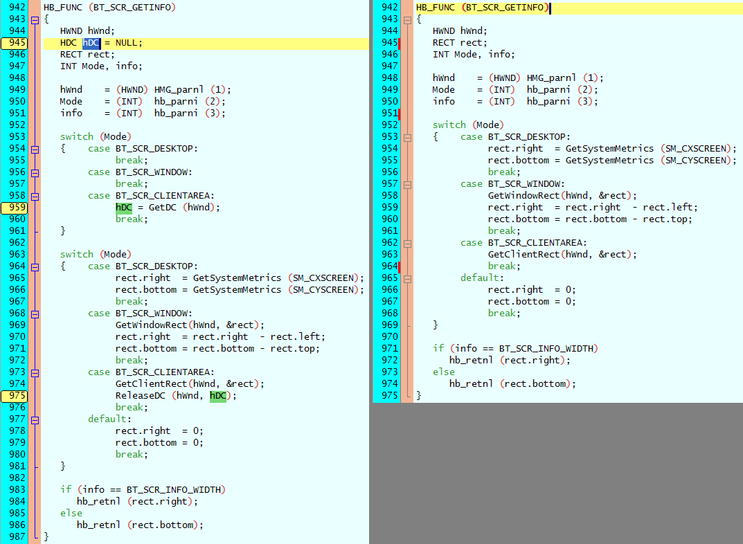

Hi Dr. Claudio Soto
By the way, I think you can remove some unnecessary code from c_BosTaurus.c. This function may look like the picture on the right.
