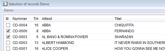

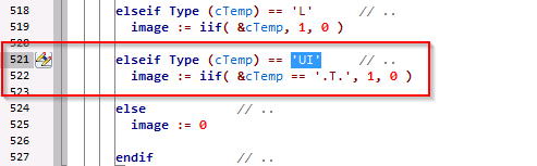

Hi Claudio,
I also developped a way to add a checkbox column to the browse control (to select records).
This requires a little (harmless) addition to de h_browse.prg (2 lines).
Maybe you can consider to add this small modification to the next release.
I can create a small demo for the HMG community (if there is interest) to demonstrate the checkbox column.
Theo
Theo

Thanks !!!trmpluym wrote: ↑Mon Jan 09, 2017 11:07 pm Hi Claudio,
Theo
Re: BROWSE: problem with events key K_UP, K_DOWN ..
Here is the demo program with selection function in the browse control (see attachement).
Like posted earlier, to use the selection functionality the program requires a little (harmless) addition to de h_browse.prg HMG source code (2 lines).
Records can be selected and unselected by double clicking the checkboxes, using the menu or using the CTRL-F12 key combination. The key combination CTRL-F12 also moves the cursor to the next line, to make it easyer to select multiple records.
Enjoy
Theo
Enjoy
Theo
- browse_select.zip
- (1.55 MiB) Downloaded 431 times
