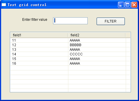

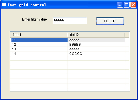

当我打开数据库(表),与之绑定的GRID 显示正常,但是当我对数据库进行过滤后,我发现符合条件的记录显示不正确.
When I open the database (table), with the binding of the GRID show normal, but when I filter the database, I found that the records are not displayed correctly.
I included my sources and database in attachment in a zip-file.

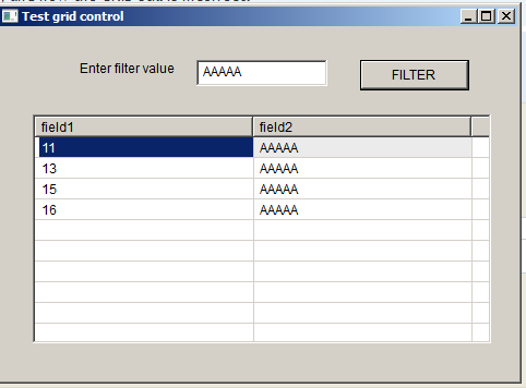

This what I get. Seems OK to me!
Please send you PRG.

Please enter "BBBBB", look at the output is correct?

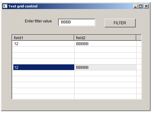

Enter "BBBBB" gives correct output for me! BUT... sometimes 2 lines with BBBBB are shown when clicking on empty lines.
Claudio, I think it is a bug. See att.
