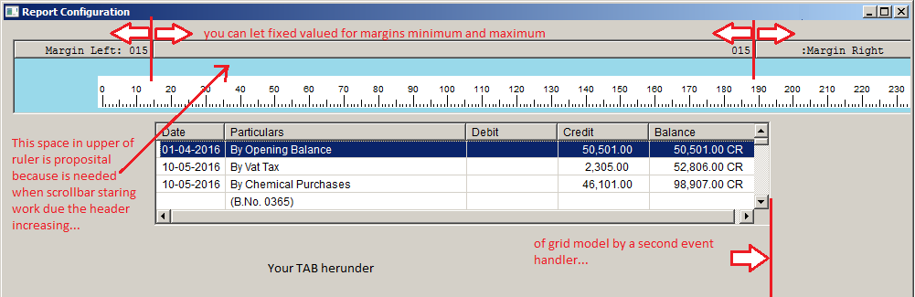

Dear Rathi,
I do not know if you did not understand what I had proposed or just you wanted to simplify doing it in a simpler way.
I have two ideas and I will try to exemplify better than maybe you can adopt to leave with a more professional face regarding respect.
1. If you want to control the margins and even the grid model sizes for the maximum and minimum size of the paper size, you could better refine the values that should be variable according to the sheet size and the sum of the 3 columns of the Grid_1 to cap the width of the selected sheet size.
Demo1.rar
(1.24 MiB) Downloaded 330 times

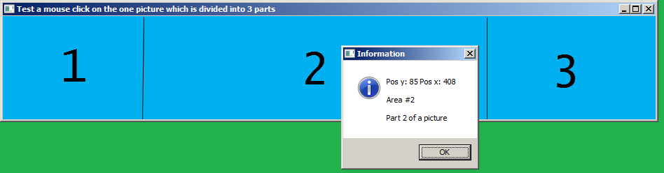

2. The other example attached here is a brilliant idea of an example of HMG EE from Verchenko Andrey where he divides the image into three parts and as he clicks on the image it says which part is selected. This could be divided into millimeters in an array and you can make the blue colored cross line forming the border or the margins. I did not test but I believe it is possible.
Download of pack of message below
In the option 1, it's not adjusted the range of each column at EventHandler. The ruler I have edited but seems it is not correct. Some of milimiters is thiner than other, probably is image adjustment. Header of Grid_1 you can display the width value of each column and font is Courier New because is monospaced (more easy with PADL/PADR).
Sorry I can not finish for you, becaause you are using OOP and also I do not know what you gonna adopt for you.

I can't attachd this file in my previous message... :( probably is a limit of it.
Here it's going...
Demo2.rar
ouse click on the one picture which is divided into 3 parts
(524.29 KiB) Downloaded 408 times
